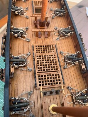

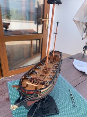

Now all the cannons are placed on the deck and fixed with 1 mm thick nails hidden under the brass piece of the cannons.

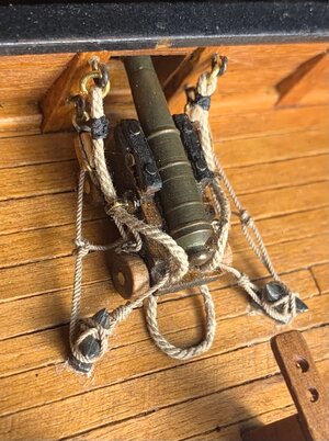

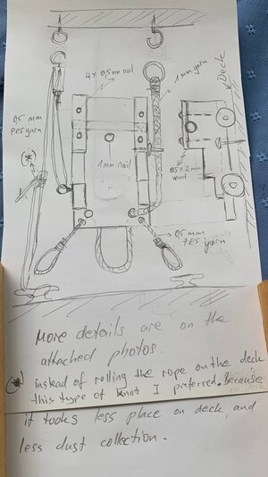

First time in this model I used the newly ordered Modelbau Takelgarn yarns 1.0 mm Co and 0.5 mm PES.They look nice .One advantage of the PES yarns is that the end of the yarn melts by a gentle flame treatment and no need to bind the ends. This offcourse can also be achieved by using some glue. Further I tied the end of the cleat hitch rope( instead of coiling it to a flake) to the main running rope so it takes less place on deck and dust collection is less . All details are in the attachments.
