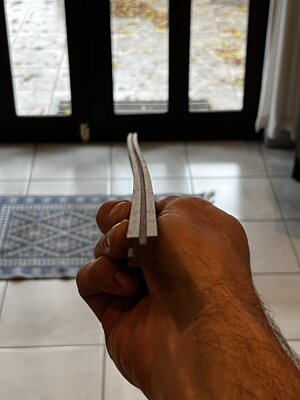

G'day all,
So I just received my model(!), which I also ordered 4 display case moldings.
Unfortunately, they are not 100% straight! two are fine but the other two are warped.
One is convex, the other looks like an S (stretched out).
Now, these are American Walnut so I do want to try to save them. Can they be straightened somehow?
TIA.

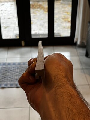

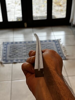

Of course, should have thought of that.
Here they are, the first two photos are the S shaped mould and the third one is the convex mould.

Wood is a natural substance that expands, contracts and moves with changes in humidity, temperature and age. particularly apparent in thin sections such as yours and when coated on only some sides. If your case is glass, it is likely the two panes at right angles to each other will hold it straight, but I wouldn't trust acrylic / polycarbonate to do so.

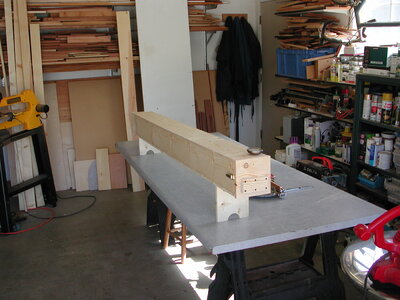

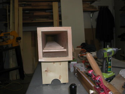

If you can suspend them inside a tube such as plastic downpipe and rig up a kettle to expel its steam up the pipe for half an hour, then clamp straight to something rigid while they cool for a few hours you might overcome it. Nothing too complex needed to steam wood unless you want it to be, I'm sure people sell fancy kit to do it!
