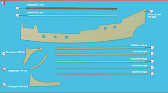

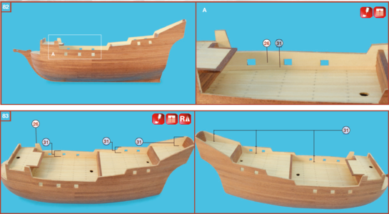

i have just bought artesania sanfransisco 11 and when i was checking the inventory of part i find i have 3 different size deck planking. as there is no paper plans supplied with this model does anyone have a hint as to which planks are used where. thank s john_j3
Your model does come with two CD's with picture instructions in .PDF and .JPG formats, plus instructional videos. There are no paper plans required for this awesome beginner kit. Did you buy an incomplete kit? If so, you can download the instructions and parts list from the following link: San Francisco II - Artesania Latina
Parts list for Planks:

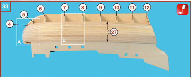

Part 27 is for the first hull planking layer.

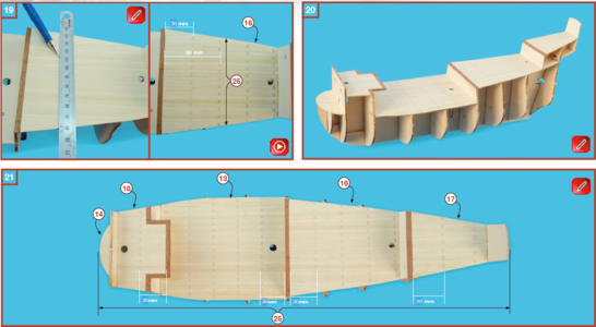

Part 25 is for deck planking.

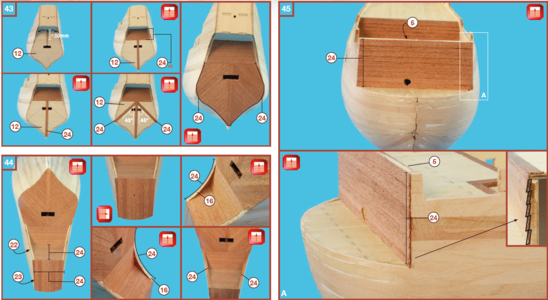

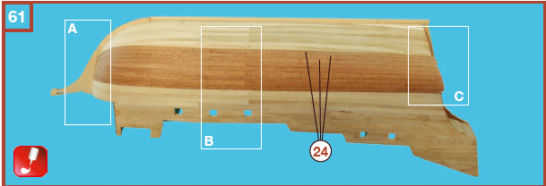

Part 24 is for bulkhead, stern and hull final planking.

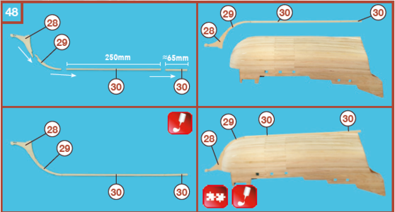

Part 30 is for the keel and sternpost.
Part 31 is for the bulwarks.
