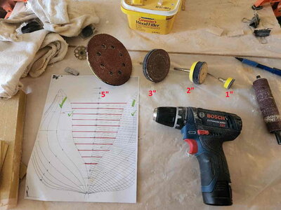

With all that said, I do own a small drill I use only for disc sanding and have 5", 3", 2" and 1" discs, along with a multitude of other hand tools used.
