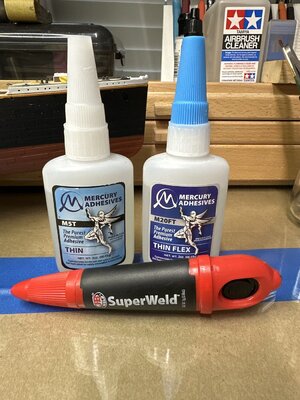

I have to agree that Loctite makes an excellent and consistent product for the price. its availability is another good selling point. A few years ago, someone recommended that I try Mercury Adhesives products, and I have found it to be anand I have found it to be a good adhesive for railings and finer work. their thin flex is great for railings
I have had good success with both, Loctite and Mercury products.

I second the Mercury Adhesives brand mentioned by AER3393. I bought mine at Woodcraft Supply in Woburn, MA but they are well-distributed. They seem to last in the bottles (capped of course). I use the 2-oz. size and after 6 months, they still flow and work. Good selection of applicator tips for precise application.
