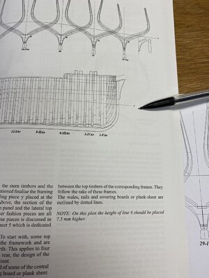

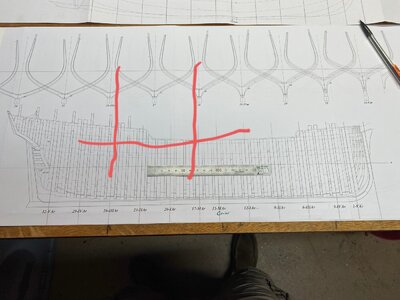

In the Ancre book there are 3 separate mentions of line 6 on the plans needed to be moved up by 7.5 mm. Seems a pretty important measurement to just have notes on those pages about it. What does this mean ? Is this an added edited note saying the plans are wrong ? I’m stumped before I even start. This seems critical to me. Help

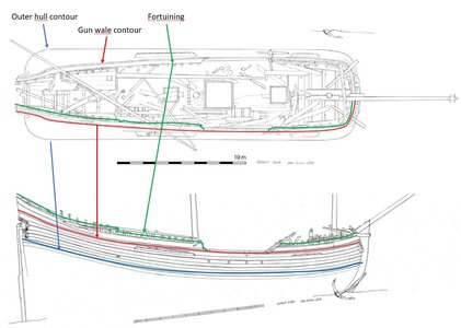

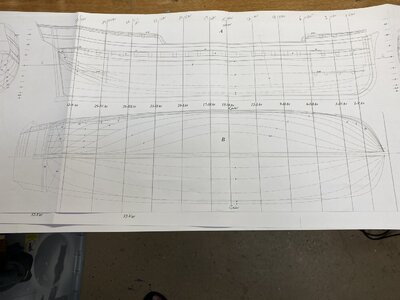

I would recommend you to check the width of the frames at line 6 with the width at the frame positions in the waterlines drawing. These should normally be equal. This should help you to solve the problem and determine if the line 6 should be moved.

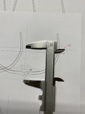

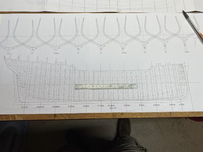

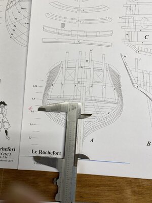

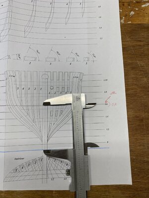

Width ? Or height you mean, yes ? I did compare all the plans one was different (it had the line in the correct? place) others had to be moved up. I’m still not certain and I have to be before starting anything.
You have to compare the width of the frames with the width of waterline 6 in the waterlines drawing at the respective frame positions.
The shape of waterline 6 should be in the topview water lines drawing
See below how waterlines work, in this case actually with wales instead of a waterline which is in a horizontal plane.
If not clear send a picture of the top view waterline drawing and I will show you.
A picture tells more then a thousand words :)

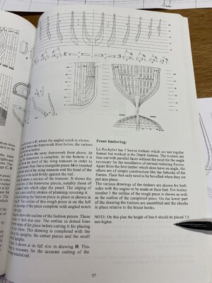

It I my says it in the booklet on plan sheet 3,4,5,6
On these two drawings with the correct number 6 line my measurement is in agreement with the addition 7.5mm. It seems they’re correcting the height of line 6 on the broadside view in the frames.
