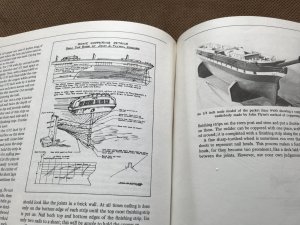

There is a chapter in this Book on Coppering. Here’s a pic. (Ship Modelers Notes)image.jpgimage.jpg
