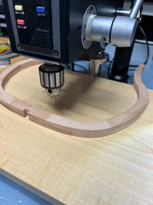

These are actually use in a drill press. Because they break easily. But in a highspeed handdrill they work to if you are careful and have a steady hand. I buy them on Aliexpress. A little cheaper then Amazon.

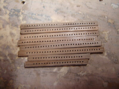

I tried the ones I bought (top post) in my milling machine for drilling pin rails and it worked a treat. 220 perfect holes with no broken bits. I guess if you use tools for what they were designed for you'll have no problems. :)

Exactly, they break only when I don't take attention what I'm doing. By the way the bits smaller then 0,7 mm. breaking more easily then thicker bits. But in a drill press they are endless for wood.
The smallest I got is 0,1 mm. And off course that one is only to use in a drill press with the workpiece stabilized.

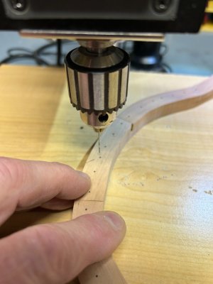

I use these with my Foredom micro-motor. My finding is that they do break when any lateral pressure is put on them. They work well when drilling perfectly perpendicular to the material your drilling. Also, I use them @ 30,000-40,000 rpm. For some reason at lower speeds they fail more. I can buy them 10 pieces each of 0.3mm, 0.4mm, 0.5mm, 0.6mm and 0.7mm for $15 per box. At this price I look at them as disposable bits.
