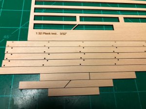

Speaking of char... been experimenting with laser cutting planks and using the char to simulate caulking. Here is some of the testing we have done on 3/32" basswood. Can also use the laser to etch 0.04" diameter treenail engravings.. or cut out a 0.03" diameter treenail hole.. angled cuts fit perfectly as well.
