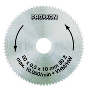

Be sure I checked a hundred times if the fence is parallel and the blade is brand new and awfully sharp. Wood burns because it is hard maple. This wood would always have tendency to leave burn marks. Last resort, I was thinking reducing a blade speed a bit to see if it is possible the maple not to burn on my machine.

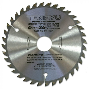

Most times the wood burns while sawing because of an incorrect blade for the type\sicknesses of the timber. Slowing the motor down will kill the motor unless you are using reduction gear (which is not the case with most table saws). Just have a moment a check the latest Olga videos when she cut 1-inch thick timbers. It is very smooth and clean. She used carbide tipped blade. Also, the thicker\harder wood you have to cut, then use the blade with the fewest teeth. Another suggestion is to move the 'exit' side of the guide just a notch away from the blade. I am using this blade.
Hi, Jimsky. Thanks for replying. Could you please take a piece of hard maple and cut it with your blade? Could you let me know if you have burn marks?
Buy the way blade you show will not fit into my saw. My saw takes 85 mm maximum diameter blade.

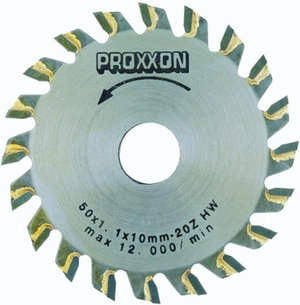

Use the right saw blade for your wood. The one you show us is not a saw to use for hardwood.
The best is that you use a blade with carbid teeth like Jim showen you. Proxxon got 2 types. 1 got less teeth. That is for thicker cuts.

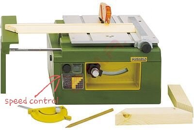

Here is the speed control of the FET
This is the the machine micro-mark copied.
If there is a speed control on the new type of Proxxon FET, I don't know. If there isn't it will be not necessary.
The actual FET has no speed control anymore (I think)
