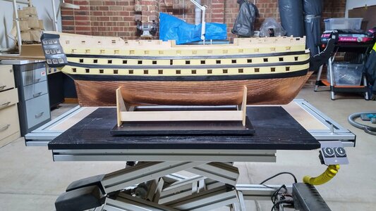

If you saw a Caldercraft Victory on eBay that had been started, would you be tempted? Last year this happened to me and I had to get it, I had no intention of starting it back then as I had other things to do.
This was not going to be my next project but as we are putting our house on the market I have to keep the shipyard neat and tidy (not the way I work). I needed something to do so this is more of research job at the moment. I need to see how far into the build it is and what needs to be done. When we are in the new house I may continue with this or start something new. The only photo I saw was the unpainted side l was surprised to see the copper plates and paint on the other side.
I've had a couple of days to check things out glad to say the contents look complete, love the drawings but the instructions seem a little bit light.Now this is where I need help or another opinion I can see things I'm not happy with, what do you think.

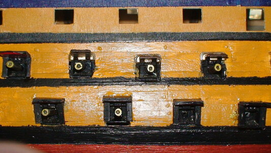

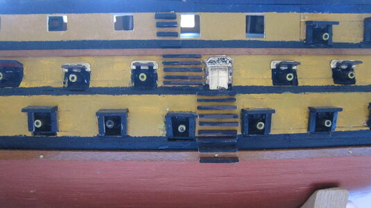

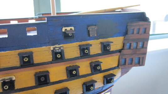

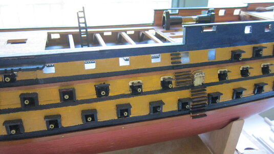

1 The painting needs to be redone lines are not straight and I don't like the shade of yellow used. Any suggestions? I'm not a fan of the current colour on the real Victory.
2 The gun ports need fixing I'm toying with squaring them up and relining them.
The gun carriages are not very good I'll pull them apart and redo them,- any tips for ungluing parts, I don't know what glue was used.
I have some other questions for things I'm not sure about, I'll post again shortly.
Any suggestions welcome I've got a lot to learn with this ship.
Good morning Tony. An interesting project for sure. The gun port frames definitely need to be redone. A large task for sure however looking at your builds one you will pull off.
The colour. I personally feel Admiralty paints are the best colour fit for the Victory. They did make these after the colour change but are not pinky more a deep yellow ochre. They have a set of paints made just for the Victory. Worth checking out

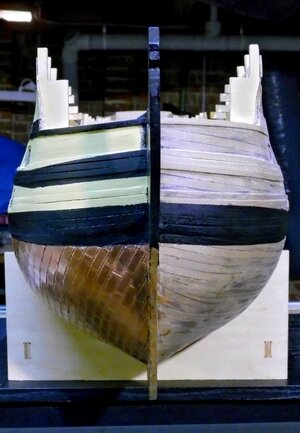

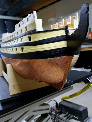

Tony ,so glad to hear from you again and you are building the victory . Photos this is how far I have got with my victory again lots of parts missing so had to make my own. Colors get all my paint from the $2 dollar shop these are the colors I have used so far yellow ochre phthalo blue ect all water based paint brushes to . Gun ports made my own some missing again .Getting ready to put masts on lots of sub assy to paint ,have enclosed mast colors if they are any use keep modeling Terry l

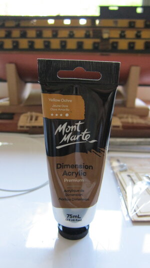

Hi Terry nice to see your progress on the victory you'll be rigging it soon. I would never have thought of looking in the two dollar store for paint thanks. Tony

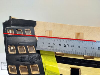

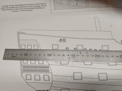

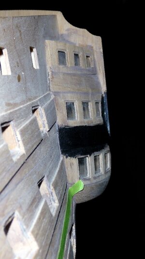

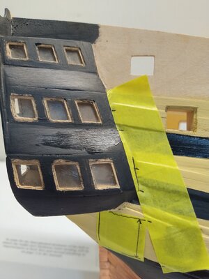

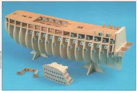

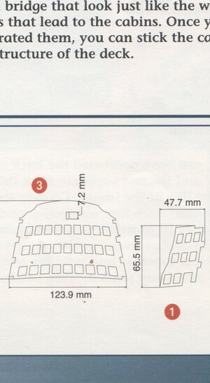

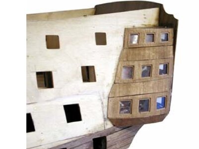

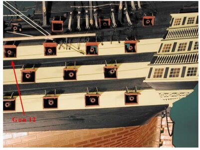

I've had a better look at my Victory and can see more problems firstly the quarter galleries are out of line with the gunports.
This is how they should line up.
See how the windows drop down at the stern.
This is from the instructions showing how it should look.

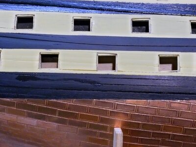

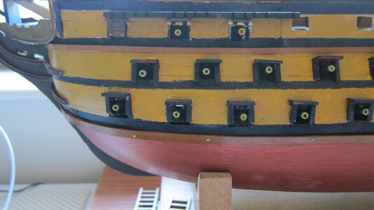

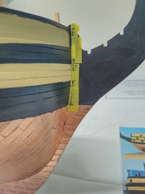

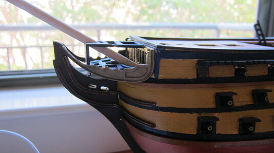

The next problem is the way the Wales have been fitted, they tend to sweep up at both ends and there is a mismatch at the bow.
I've put masking tape above and below the lower wale to highlight it's path. It's ok till it gets to the last gunport then it goes to high.
Here I have marked the height where the wales should end up. While doing this I noticed that the copper plates are above the water line.
Another photo of how it should look.
It looks like I need to remove the wales, quarter galleries and some copper plates unless there's another way to fix these issues, any suggestions welcome.

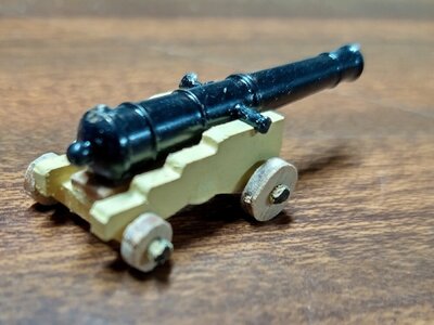

To unglue depending on what was used, I have just soaked in warm water with a bit of rubbing alcohol to help it absorb into wood, for CA use finger nail polish remover or pure acetone, but be careful of smell and chance of fire with acetone, best soaked outside in fresh air.
Give them time to soak and gently try prying apart.
Thanks for the advice I'll start with the gun carriages using water and take it from there. My biggest problem is not knowing what glue has been used.
Good morning Tony. The quarter galleries fix is something I would definitely do. Those out of line windows will be a glaring irregularity- drive you mad. It is just wood so you will get this spot on. This would be similar for the wales. My wales also swept up at the bow and I managed to create an illusion of this not happening with the water line and the planking around the anchor haus. See my bad wale ROTF.
However:
If you can I would redo them and the copper plates by the water line (if possible). (I don’t have any idea how to do this) Definitely will make a difference and be correct. Good luck and enjoy. Cheers Grant

I only have one side copper plated but it may need some work as the water line is to high at the bow and stern.

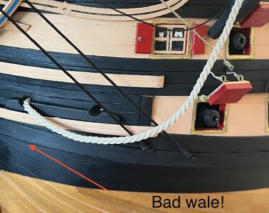

I sold my Caldercraft Victory kit to another SoS member. I was just thinking, I should open one of the paint containers and check the state as they are 4 years old. I won't do that unless you decide you might want them.
