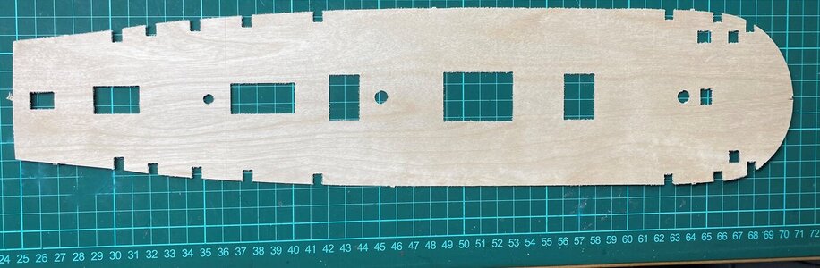

Is anyone building or having access to the plans for this kit? I am trying to see if the plan set has the 1:1 template for the False Deck. Also, does the False Ply Deck is in one piece or is it in several pieces to glue down on the Bulkheads.
Thank you to anyone that can answer this. I know someone that is building this kit and Caldercraft kit did not have the false deck (it was missing) and he has contacted Caldercraft with not good communications. They gave him a quote for the missing ply deck at 18.60 but they did not tell the guy HOW to buy the part, no links, no info at all. Something just seems rather strange about all of this.
The manual says it should be 0,8mm thick, but mine is exactly 1mm.
The lenght is exactly 45cm.
There are several deckplans, but always with equipment and the exact lines are covered by e.g. the gunwale, etc.
I can try to create a copy and make a PDF out of it, when i'm back in the office in two weeks...
