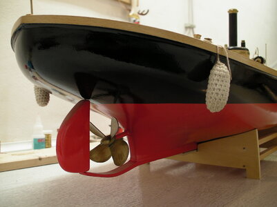

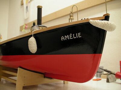

Hi OldGit!
My Borkum "Amélie" weighs 8,5 kg with everything (including the steam engine and boiler) and floats on the KWL (construction waterline).
Weight steam engine and boiler filled: 2,3 kg.
Best regards
Thomas
