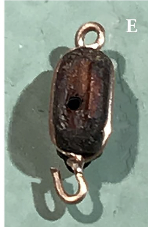

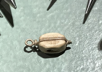

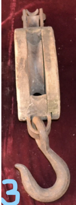

@Uwek , here are a couple of pictures from the instruction manual

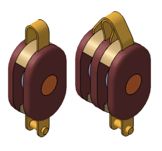

This are kind of small and might not be a big deal, but I was wondering if the block below would be contemporary:
I found a cool manual of how to build this type of block. I've made built up blocks before from scratch, but not with a brass strap between the face and center. And I make nice, if not entirely consistently sized, hooks.
Anyway, may be letting my ambition run wild. It would be interesting to know if this proposed block would have been used at the introduction or even lifetime of the lobster smack.
Any insight appreciated.
