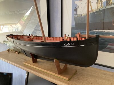

Bisquine de Cancale
Fantastic work on a great little boat, congratulations Kerz Atao. Perfect. JJ.
I am impressed by your workmanship - just "BRAVO"
very prezise and accurate work - the wood, but also especially the metal works
In which scale is this model?
On Ebay you can regularly find Jean Le Bot's monograph which I highly recommend.
For example this link :
Hello
Extraordinary and detailed work
I love painted boats without scale errors like your model
My congratulations
All the bestOkayThumbs-Up
Excellent!

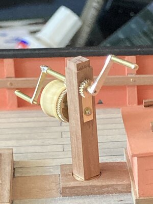

Hello,

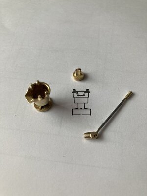

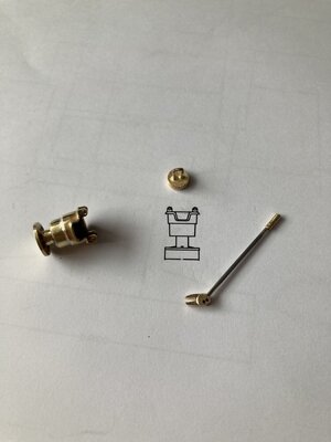

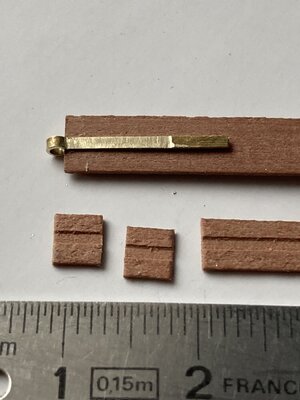

A small step by step for making tiny pulleys. For this size I did not plan to make the sheaves.

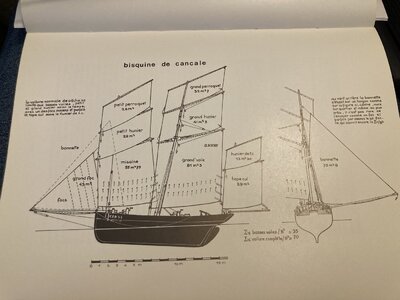

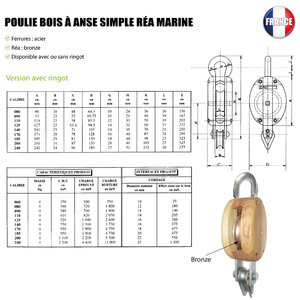

According to the drawing below I needed 90 caliber pulleys in 1/33 scale.
Shaping a 0.3 mm brass strip
Installation and gluing of the folding obtained on a pear slat 0.5 mm thick.
Decrease in the thickness of the brass band on both sides.
Cutting and gluing of the flanges obtained from a pearwood slat grooved to the width and thickness of the brass strip.

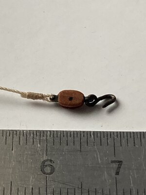

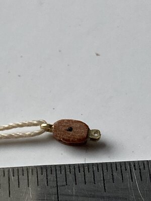

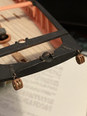

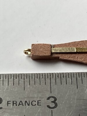

Pulley finish
This one, with the additional sheaves, was manufactured on the same principle as above but the assembly was completed on the fitting ring.IMG_5879.jpg
For the details the macro photographs do not forgive.:mad:
wonderfull work on the block
