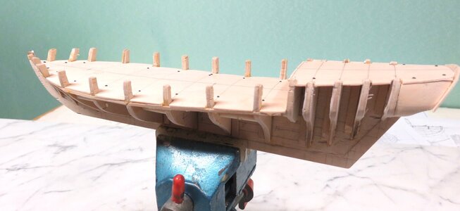

Skeleton Construction
The keel piece and bulkheads were made from 1/8” plywood. After the bulkheads were inserted into the keel piece, sections of 1/4” dowel were glued between the bulkheads to stiffen the skeleton and prevent warping. Filler blocks were also added at the bow and stern.
Next was to add the decks. A cardstock template was cut for the main deck and slots were added to fit around the bulkhead extensions.
A similar template was made for the quarter deck. These were then used as patterns for the 1/32” plywood sub-decks which were glued and nailed in place.
