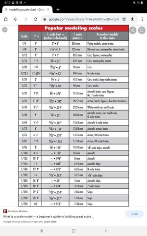

or...use this online calculator. What could be simpler than that

A useful chaView attachment 287916rt:
