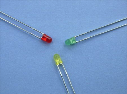

For smaller scale models or the stove/fire in your model I suggest using small LED bulbs available in red, yellow or clear for using in a fire or stove.
They are avalable from most Railroad Hobby Stores (not toy stores). They are 1/8 " in diameter about 3'16" long with two wire leads from the back that take the supply. For Miniature train use that are connected with a resistor on one lead to work on the normal railway 12 volt system.
I believe the LED works on about 3 volts (please check this) a so a matching battery supply at this voltage would eliminate the need for the resistor and occupy less space.
I ho[e this may be of some help, best Wishes
