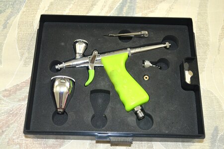

I am in no way an expert in airbrushing however, I tried many different airbrushes in the past and really like the Grex pistol grip unit. Available with any needle combo you could ask for. I use mine with their compressor and IMHO it's the best.
Of course an airbrush is just like any other tool. It’s up to the end user to get the right mixture of paint, air pressure, spray pattern ,etc.
