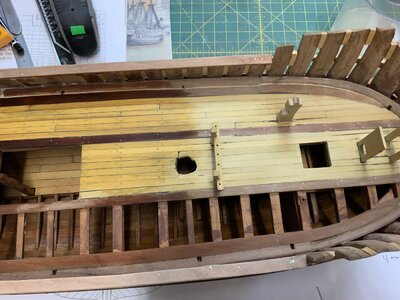

Seen this on a woodworkers You Tube Channel. To give wood an aged look can apply water solution of baking soda. I’ve tried it on Castello Boxwood. What do you think? I’ve not applied varnish yet.
You should have tried it on a test piece not the model. It just makes it look dirty not worn I think. Is this Rochefort ?
Looking at it I think it gives the decking and aged look, There is no doubt that decking on those ships probably looked more aged and worn than that O like it
HaHa. No worries. The whole model is a test. The deck is now one colour and will be sanded and varnished later. It won’t look as bad as it does now. I did do a test piece earlier. I’ll post some more photos later.

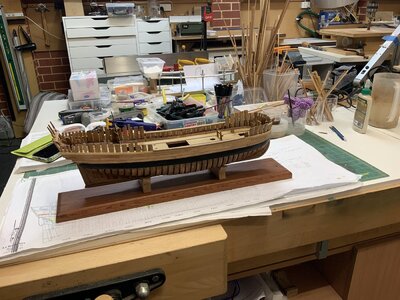

I hope to show a summarised collection of photos of my progress so far. I thought there was a place on the forum where one can post photos of a build without doing a build log?

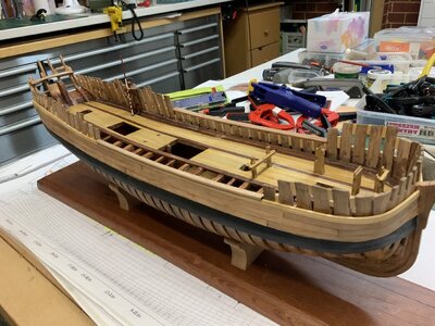

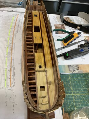

This a work in progress photo of the deck having been treated with Caustic Soda. Then sanded and Matt clear varnish applied. A long way to go yet however. Still to sand and varnish hull planks, plank the insides and etc etc.
