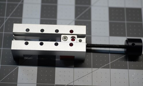

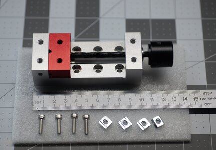

The first impression - it is a very good tool. It is well made and 100% depicted all the specifications provided. While the official name is Flat clamp, it is well suited as the vise for milling machine or drill press. With provided 4 machine bolts and t-nuts, it can be mounted on a composite table. The vise does have precision and squareness across the borders. Here some photos.

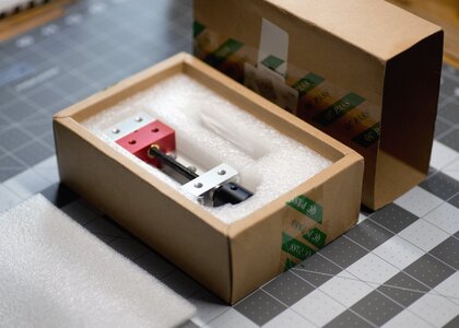

The tool came in the nice presentable carton box.
The tool is well packed in the styrofoam holding the vise firm while transportation. It has two compartments: the first one for the vise, and the second for a bag of screws.

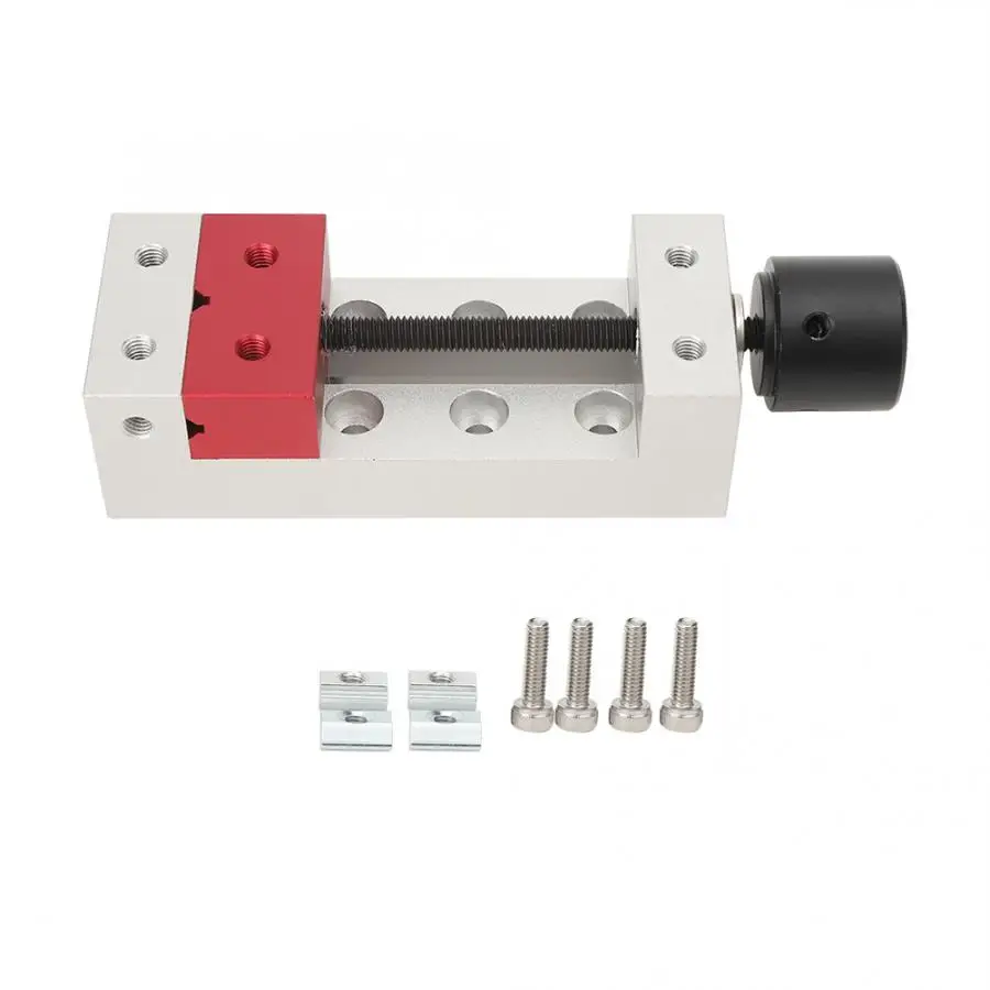

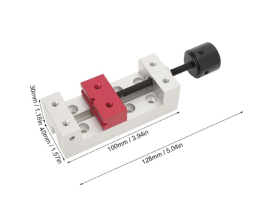

Here is the content of the package. The tool length is 100mm\130 with the handle (yes, that small)!

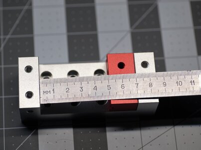

Jaws opening are 50mm.
The vise is very well made and has precise movement. Backlash (if any) can be adjusted by a set screw. Mine came with slight backlash, but it was an easy fix by tightening the set screw.

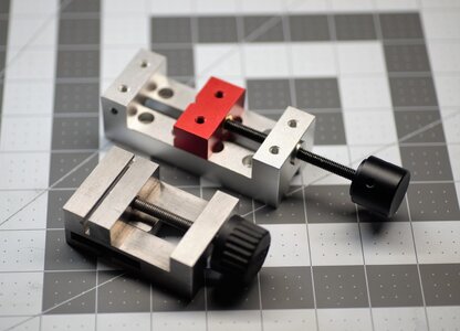

Here is the comparison with my Proxxon vise.
Here I mount the tool on a compound table of my Proxxon mill.
Conclusions
This is not the machinist vise! It is made with anodized aluminum and very lightweight. It does have a degree of precision and can be used on the drilling press and milling machine process the mostly wood or brass. It certainly can hold the metal parts but can damage the aluminum jaws. Because it has threaded holes on top, you can easily fit large and odd-shaped pars for further milling\drilling. I bought this vise\clamp to use with my drill stand so I don't have to borrow my Proxxson vise back and forth. ;) The tool is really good quality and worth the money. If anyone curious about how to own such vise\clamp, below is the link! Happy clamping!!
