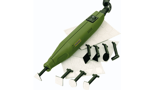

I can imagine, that the Proxxon Pensander could also work on some area
