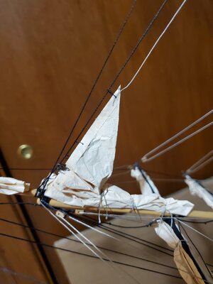

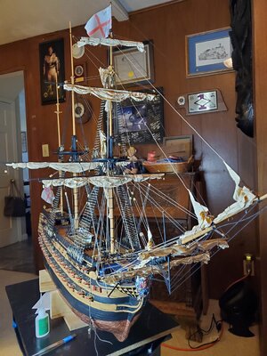

3. I have been using select pieces of muslin, very old linen (the real stuff) - mainly 100 year old 'snot' rags (one sail per 'snot rag' ) with a hundred washings each from estate sales, silk and other "stuff". However, to date, absolutely nothing adequately emulates the original sail cloth re' the enclosed picture;. Paper (any version of it) is a definite 'non-starter'; it all turns to dust in a decade or two.
