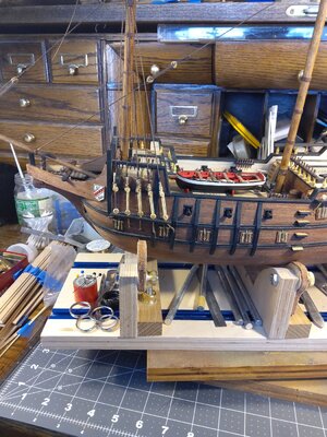

I first serve (seize) the center of the shroud then lace it through the throat, leaving each end longer than necessary. The next step is to insure the deadeyes are at the same level with a brass wire clip to old the deadeyes while I wound the shroud around it. I use an alligator clip or small hemostat to hold the line while I tie/serve the ends above the deadeyes. 20210802_123624.jpg20210807_123613.jpg20210821_120146.jpg20210816_134002.jpg

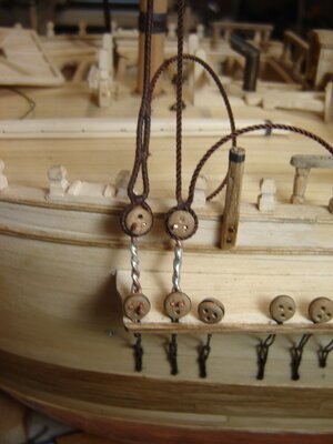

Hi Don, my solution was to glue the rope to the groove in the deadeye before attempting the seizing. I used CA for this so it only takes a minute. By doing this the length of the shroud is set (temporarily using an alligator clip as Stephan suggested) and I wasn't trying to hold everything in position while creating the rather difficult seizing.

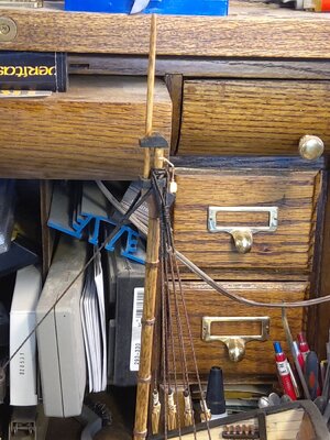

Here is where I am after about a week of tussling with this. So far all serving has been done off the ship on a jig. It probably took about five tries to get to here. Right now I need to serve the tag end up around the shroud. Thanasis, is there a way that your jig can help me here? If I try to do this manually I'm sure I will end up swearing (a lot:)). I don't seem to have enough hands. Should I be anchoring one end somewhere? At least the shroud is held taught in this instance. I can't imagine trying to do this on a loose shroud. My hands just won't do what they are supposed to. Thanks for all your help so far. I'm sure there is a way around this other than starting the build ten years earlier:)
Sorry, forgot the pic.
