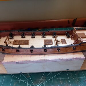

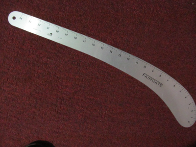

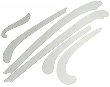

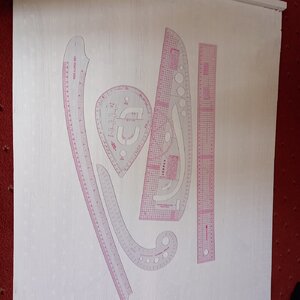

I was thinking of buying some ships curves to act as guides when cutting unstraight lines. They turned out to be rather expensive but I found a cheap alternative (e-bay) which seem to be called 'tailors curves'. Used, I gather, for dressmaking! The first picture below shows the the complete set. The second shows a preliminary application when I wanted to cut a temporary support for my current model (Phoenix) when laid on its side. I laid the long curve against the side of the model and found that the section between 8" and 17" was a good fit to the hull. I cut a piece of plywood to match and cobbled up the support I needed.
For future models it might be useful to record which sections of which curves match each bulkhead to provide data for making cradles, support stands, bending guides or customised clamps. Horizontal measurements at various height above the keel may be useful too.

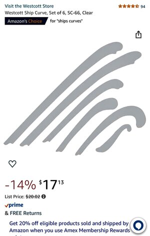

(In my working days we only had one french curve in the office; we reckoned that all graphs in our technical papers had the same shape!) £4.84 on Amazon. Ship curves are longer and straighter and for some reason seem to cost £41.79. The tailor's curves I bought were a compromise at £13.99 and included a couple of longish components. The scales marked on the edges are a useful bonus.

Got the same set at the top from Aliexpress, cheap but very thin and prone to slip on the paper. But they are useable and you can use them as a template to make more robust ones.
