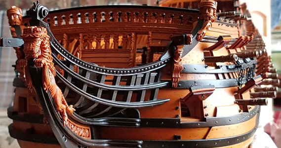

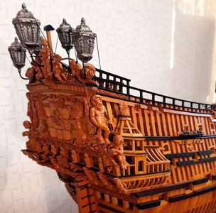

I used shellack on my Endeavour and will continue to use it on my future models.
