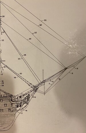

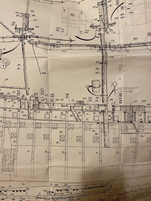

Thanks. But I am asking about the models, not actual ships. The model of a kind sown on the drawing below. Is it glue, standing rigging with no glue or different type of mounting? How do you guys manage?

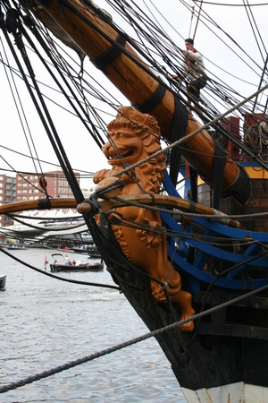

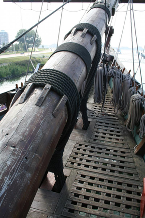

The bowsprit mast has no shrouds to prevent it rotating around the axis. Is not it? Looks as it must be secured somehow.
... a bowsprit mast? Do you mean Foremast? Each mast has its own set of ratlines shrouds and backstays. All those rigging will secure masts good enough from rotating.
I mean bowsprit. What prevents it from rotating on the model unless it’s glued or pinned with a screw or something.

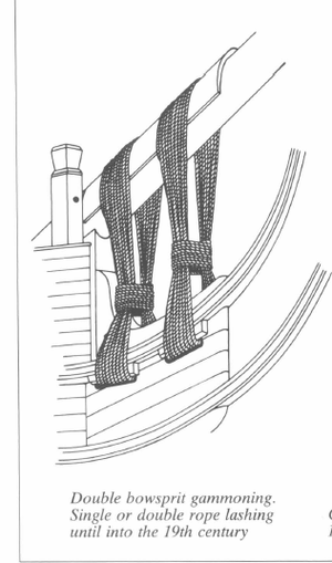

aha...got it! The bowsprit was secured with the gammoning rope. On the model, you can secure as well. Also, the bowsprit has its own shrouds on starboard and larboard.

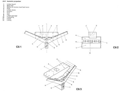

On an Admiralty style model (Plank on Frame), withing the Keel are Mast steps with square openings. However, I assume that you are working on a Plank on Bulkhead which is using a false keel which then uses a long vertical slot to insert all of your mast in.
