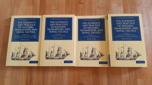

The Elements and Practice of Rigging And Seamanship, 1794, by David Steel, is a comprehensive English textbook of rigging, seamanship and naval tactics. A key reference for those interested in the age of Nelson. Although at times difficult because of its fine detail, it will reward those that search through it to understand the technology of the era.
If you don't like reading the PDF on a computer you can get them from Cambridge. https://www.cambridge.org/ca/academ...igging-seamanship-and-naval-tactics?format=WX
I have downloaded Steel's book. It's a bear to wade through. I'll put it on my I-pad for bedtime reading and give it an harder look.
