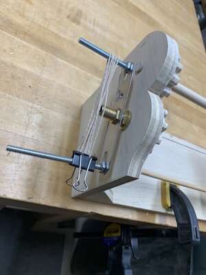

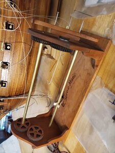

I’m cheap! So I made my own following the Syren servomatic idea. With some scrap plywood and about $6.00 (usd) in lamp parts from the hardware store. Presto it works great. That said I did replace the homemade wood gears with 3D printed ones in version 2.0 (sorry no current picture). Now it works even more smoothly. IMG_7973.jpegIMG_7972.jpeg
