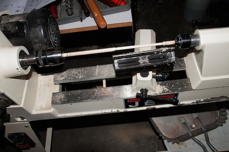

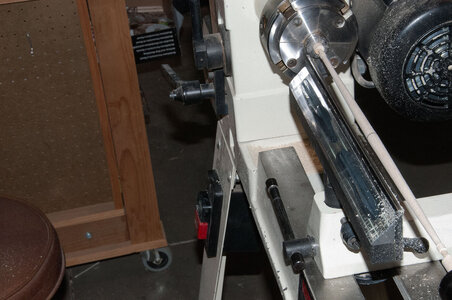

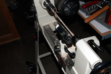

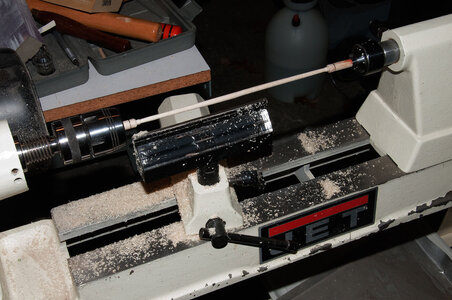

I taper masts and yards on a Jet lathe. I use a collet set that is hollow and lets me insert a dowel (must be <3/8" dia) as far as I want. I also use a 4-jaw Nova chuck and a Jacob's chuck from time to time. They all work well but longer pieces must be sanded/turned lightly. Not fast work at all. But on really thin or wobbly pieces, I use a steady rest midway along the dowel.Nuestra_708.jpgNuestra_707.jpgNuestra_706.jpgNuestra_743.jpgNuestra_742.jpg

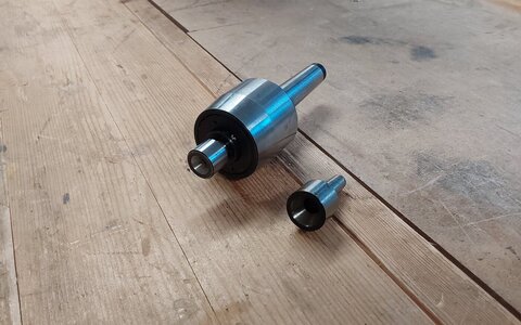

I have a multi purpose set of live centres which includes two interchangeable negative cone centres. Installed into lathe tailstock it is very easy to use with the work supported by a rotating negative cone.

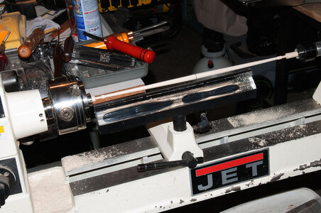

This is how i taper long pieces
Thanks Kevin, I've watched all your videos a few times. Thank you for them. Unfortunately my lathe is a combo lathe/milling machine and there is no room for a steady rest as the cross feed doubles as a table for the mill. Here I'm using the mill. Sorry for the blurry pic.

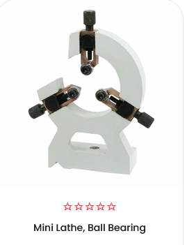

I am just now seeing this post - yes, the reason for the deflection is the dowel that you are turning is thin. In order to avoid this, you really need to have a "Steady Rest" mounted either 1/3 or 1/2 or 2/3 of the way. The Jaws will just touch the work piece and keep the dowel from deflecting. I don't remember seeing a post of what kind of Lathe you have. The bottom part of this slides our mounts to the "ways".
