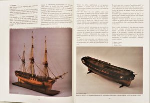

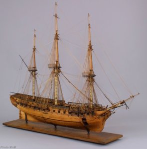

one of the contemporary models of the Musée de la Marine

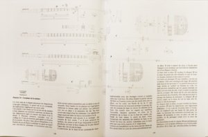

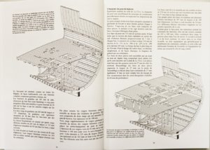

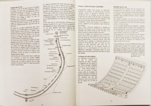

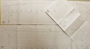

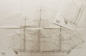

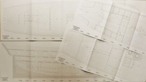

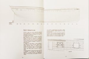

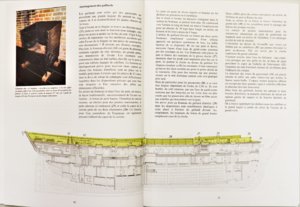

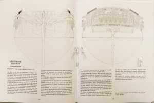

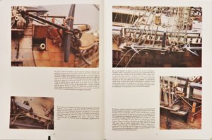

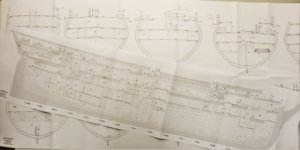

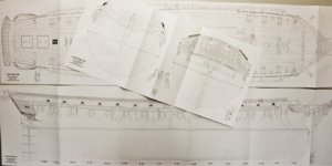

My first impression and Comment:
It is a high quality monograph, with very good and detailed descriptions in the booklet, which is with with 219 pages a bigger one. Very good and informative colored photos of the existing models, also colored excerpts from drawings in combination with detailed explanations of the french history of frigates with their technical development. Also construction details are explained, so also a great source to understand in principle french frigates -> It is great booklet (take a closer look at the "Look Inside" - photos and you will understand.
Also very positive is the bigger number of drawings which are attached. It seems, that every detail is shown and a great model can be constructed. What I like very much is the fact, that Gerard used very thin thickness of the lines in the drawings - in my opinion very good for the accuracy.
And also very important:
The ship is very very attractive - I was falling in love with this vessel - and I am sure, I am not alone.
I can imagine, that the L'Egyptienne monographie will get a reference planset and a lot of modelers will try and will finalize a model.
This ship is now for me on the top of my personal list of possible scratch built models - I think, that I will try (and hopefully finalize)
This new monograph is highly recommended - do not miss it !

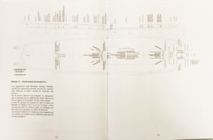

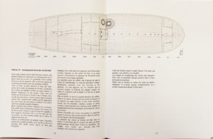

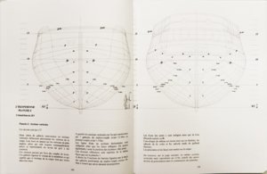

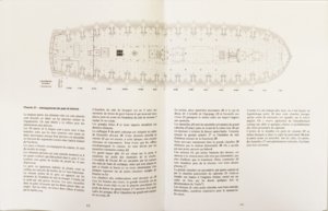

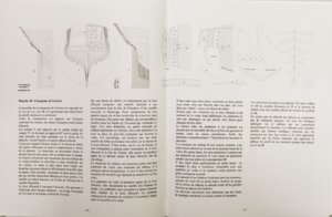

Look Inside of the booklet:
More Look Inside photos of the booklet and all drawings you can find in the following post .....

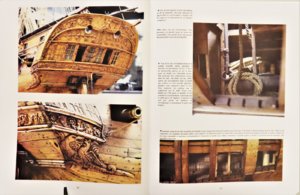

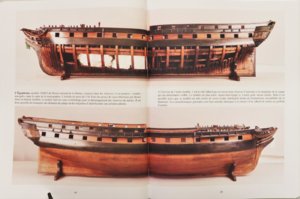

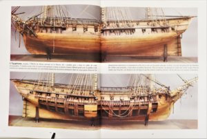

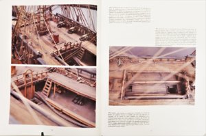

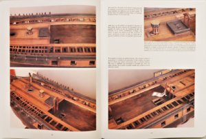

Look at these beautiful contemporary models!

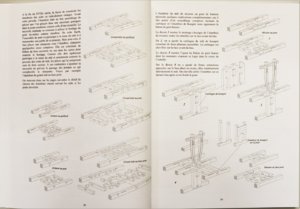

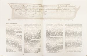

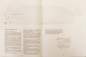

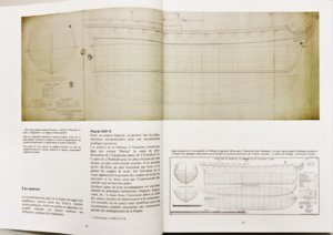

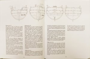

The monograph by itself - every drawing is explained and described
Sorry for the bigger number of pages, but I wanted to show the quality and content of this given information.
Like in a book shop and you thumb through a book in your hands

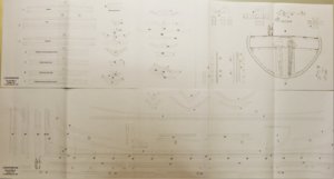

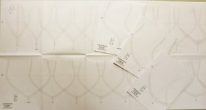

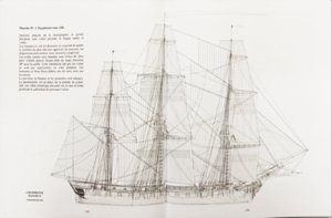

Planset Review: PART III
L'EGYPTIENNE
24-prd French frigate - 1799
in scale 1:48 by Gerard Delacroix alias our member @G. DELACROIX

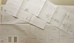

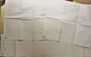

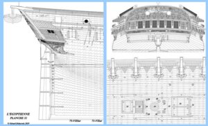

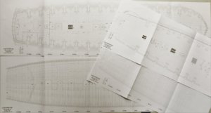

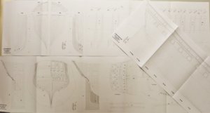

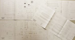

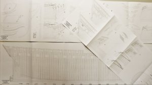

Look Inside of the Drawings
I guess, now you understand, why I was falling love into this ship - Many thanks to Gerard, for this "masterpiece"
In the next weeks I will start to study the drawings and the given information.......

Yesterday i had the luck to meet a friend to take a deeeeeep look into the planset from the LÉgyptienne. What a big pack of plans !!!
The Planset is really awesome. When you take a look you need to cancel all your open projects and to start immediatly with the build.
In my opinion it is a benchmark in quality and detailism. Bravo Zulu ! Well done, Gerard !
