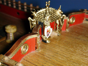

I have noticed several different variations of the belfry on models of HMS Sovereign of the Seas. Some are half recessed into the forecastle, some are an individual standing structure, and the new book cover coming out in a week shows no befry at all. What evidence do we have on the design of the befry for SotS? If there is no information available, what information of the English befry exists to draw a conclusion on and make an interpretation?

Embedded within forecastle. Build by Doris Obručová:
Embedded within forecastle. Build by Janos:
Standalone structure on forecastle. Mantua build by Pirozzi:

Kurt,McKay is right,we don't know,in fact there are many things we don't know about this ship.I have ordered the book myself,I know many things in it are different to how I perceive them to be.I feel in some aspects Sephton's book my be better

This article is highly critical of the Sergal kit and gives lots of links to go further. I took ideas from it not only for the cannon barrels but also for the belfry etc.
And I try to consult the James Lees book (Masting and rigging...)... sometimes it goes, sometimes it doesn't... The decorations have been taken mostly from the Busmann-book. I did not exclude some artistic freedom either. (ie. the stairs to the belfry)

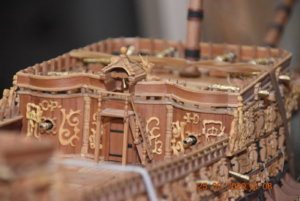

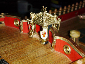

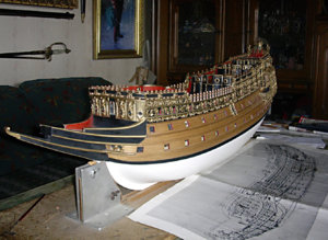

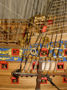

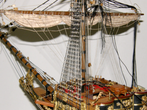

Janos told you from the model of Doris and I must say that the belfry he made was after the belfry I constructed for Wolfgang Rotter in 1990
The construction with the four Animals on the corners of the belfry was also mentioned in Hendrik Busmans Buch about the decoration of the Sovereign.
More about the Model of Wolfgans Sovereign you see in close ups by. SoS A little bit carving and the model of the Sovereign.
regards
Willi (schifferlbauer)

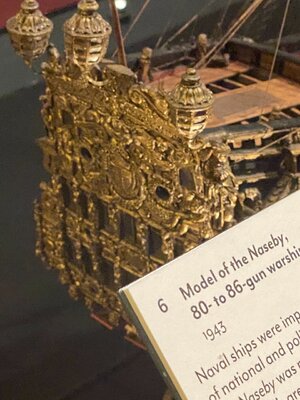

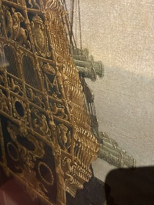

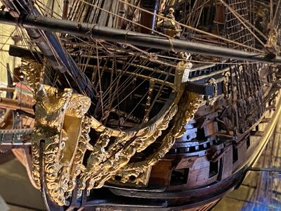

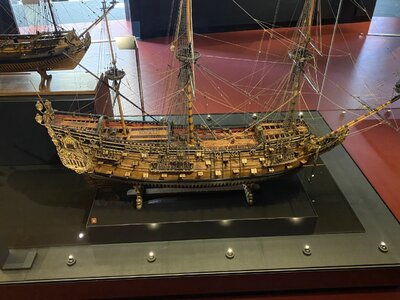

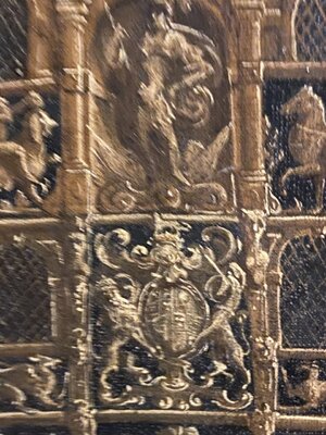

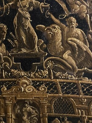

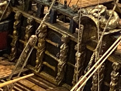

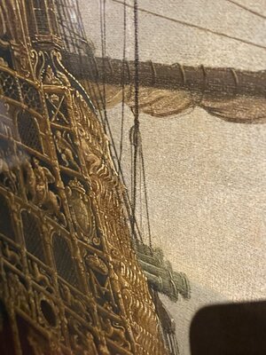

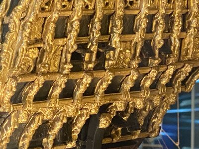

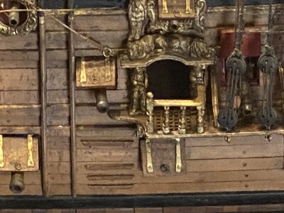

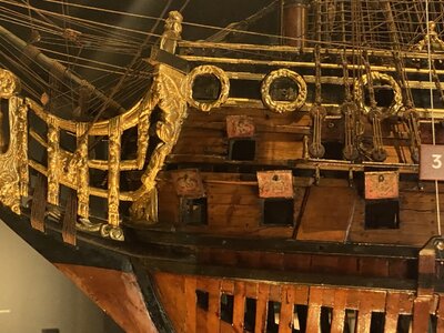

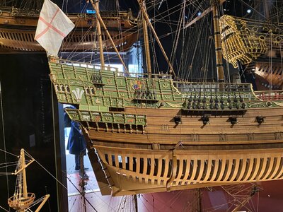

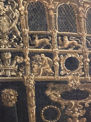

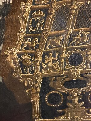

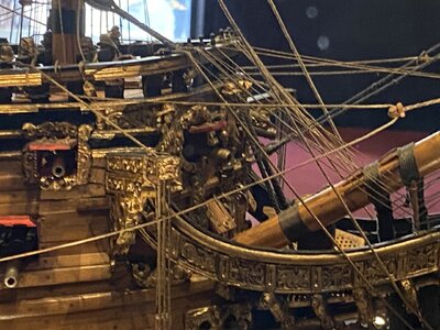

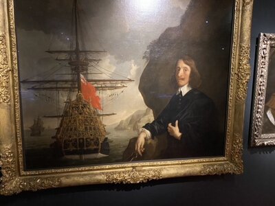

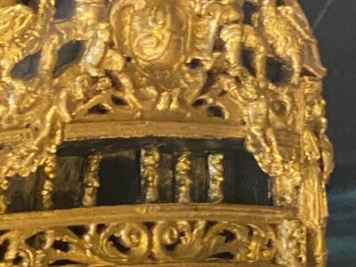

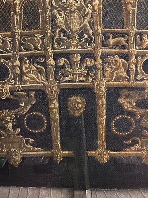

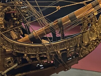

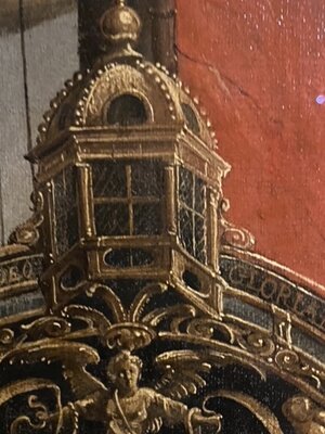

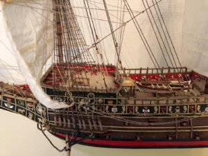

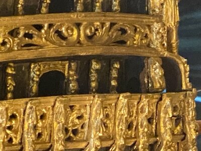

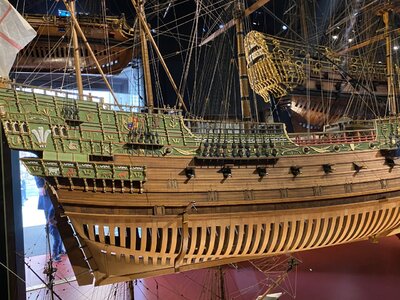

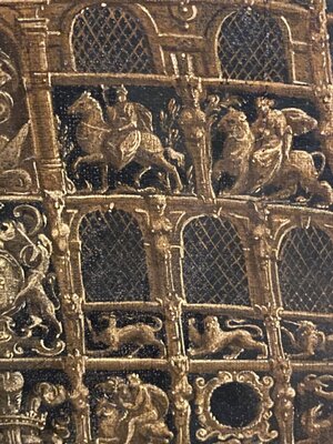

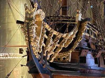

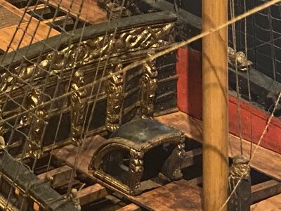

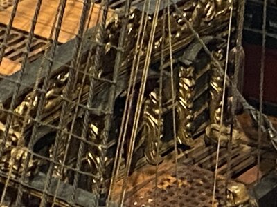

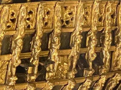

i love this ship, no i am obsessed with it , lucky me I live in London UK so I have access the to the maritime museum in Greenwich . sad;ly the library was closed on Saturday and the scale model has been moved to a different location, somerset house, strand , but they still have the famous painting of her stern and few ship of the same era , very similar ornament and structure , so it give us a general idea of what was the fashion at the time zoomed in pics from the painting
Vielen Dank, Willi! I notice you are in Austria. Meine Familie kommt auch aus Österreich. Thanks for the background information on the beflry. The whole story of the British royal line is like reading the script of a soap opera.
ypur work is just amazing , the step by step of the build is a dream , thank you sooooo much cant wait to start mine
Thank you SO MUCH for providing us with close up photos of Lely's Portrait of Peter Pett! These are rare, detailed primary source material for those of us like me who are tackling the daunting task of modeling this legendary ship. :D Thumbs-Up
i fell you, i am in the same process with her, I will come back to the library museum as they have a very good book with all the carvings details, etc.. ad take a pic of it and go to the somerset house as soon as I can to see up close the sale model
