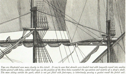

Before the footropes were introduced, topmen would simply run out along the tops of the yards, then sit astride the yard when reefing sail. That would seem to be easier on the thick lower yards than on the much thinner higher ones, so I don’t know why footropes were introduced on the lower yards first. It might be because, before the late 18th century, the topsails and topgallants would normally be furled at the first sign of approaching foul weather and not set again until the wind moderated, while it might be necessary to take in or let out reefs on the courses (lower sails) in the middle of storms and high winds with the ship rolling crazily. Later on, it became common to weather storms under one or two tightly reefed topsails and a jib only, but that was sometime late in the 18th century, long after all the yards had footropes.
Lausanne’s The Great Age of Sail, showing a sailor sitting astride and furling in the old way.
