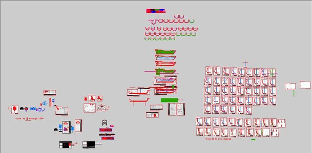

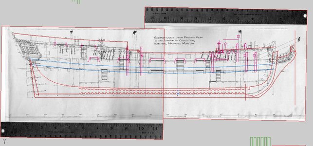

this is a working master drawing in Auto Cad. The white squares are scans of the original drawings that are being traced.

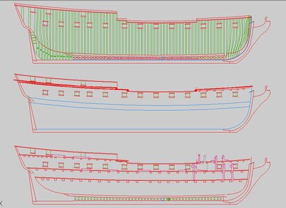

like this
from the original plan i create 3 views an inside profile an outside profile and a framing plan. As i develope the drawing more and more details are added.
