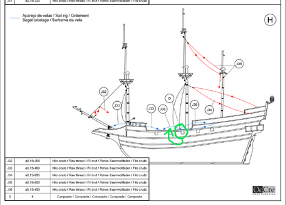

Thanks, Jeff. Yes, I understand that the rope goes on both the starboard and port sides. But I cannot see where to attach them. This is the area that has me confused (circled in green):
J36.png:
Looks like they both run to back deck where the rudder or steering wheel would be located, so the helmsman can make adjustments as needed.
I've got the J36 rope that runs to the back deck figured out but it's the J36 rope that runs in the opposite direction I can't figure out. Pictured above, circled in green. It looks like it's supposed to be attached to the main sail but does that make sense?

ahh. I would say there would need to be some sort of block there since the pull on that line while under sail would be great. It looks like the drawing shows the line coming down to the rail and then heading either fore or aft.
This is my first build and only after the fact am I understanding how rigging works.
Yes, it makes sense. There has to be lines connected to each corner of a sail to control it. That corner is held down so the sail form a "belly" to catch the wind.

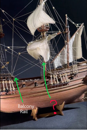

'D' is a pulley. The pulley only has one hole in it. Here is a photo I found of someone's build of this ship. It shows the rope I'm asking about but I cannot see where it attaches on the right. The left side as we're looking at it attaches to the balcony rail. But the right side, I have no idea. To the sail? (see red question mark)
I believe it would attach to the lower corner of the sail. But that's an educated guess on my part, I've not built this kit.
If anyone on here knows better, please speak up. :)

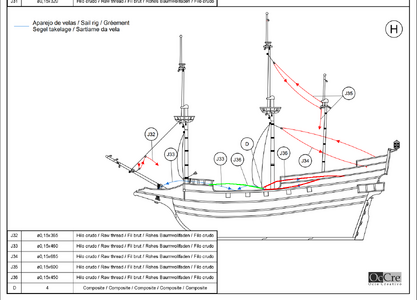

I've added red and green lines:
The red lines are the Sheet, which keeps the lower sail in place, attaching to the corner of each sail with a pulley/block. It usually runs from a fixed ring on the side of the quarterdeck, to the block and back to a belaying pin on the quarterdeck. In my experience, usually along the side of the ship, but on the plan view, it shows it on the deck of the ship instead.
The green line is the Tack, going again from the corner of the sail forward to a point on the forecastle. It could be to the rail, or again a cleat or pin on the forecastle. The general location is shown in the plan view. This helps keep the sail in place to be full of wind. No block is used here.
Both of these are duplicated on each side.
Line J34 is the Brace for the mainsail. It attaches on each side to the end of the mainsail spar, using a block, and is rigged similarly to the sheet described above: Usually a ring on the quarterdeck hull to a pin or cleat on the side of the quarterdeck.
J35 is the brace for the topsail, similarly rigged to the spar, but connected to the mizzen mast.
J33 aft of the foresail is the foresail Sheet, and should be rigged similar to the sheet above, but further forward on the ship. It should have a pulley/block on each side with 2 lines, like the mainsail Sheet; this is not shown on the rigging drawing but should be there.
J33 fore of the foresail is the foresail Tack, and should go to a point near the bowsprit, often through the side hull at this point to a cleat. It goes on both sides.
The rigging diagram for this model is actually pretty poor (okay, it downright sucks), so it's no wonder you have questions. I hope this helps a bit.

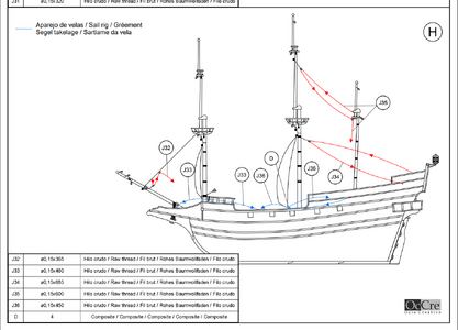

The sheets run from the clews, outside the hull and back in through a hole. They are shown in the plan as running to possible eye bolts. I would say it's far more likely that when they come inboard they attach to cleaats on the bulwarks.OcCre_Maqueta_Barco_Madera_Buccaneer_lateral.jpg
As signet mentioned, each of the courses has a sheet and a tack. Sheet to aft and tack to forward
The sheet is pulled tight on the lee side, and the tack keeps the shape of the sail on the weather side, hence « on the sb tack » meaning the wind comes from sb.
So if the j36 rope is pulled backwards on one side, the j36 rope on the other side would be tight fwd. it’s kind of awkward as models tend to have sails set for a downwind run, where only sheets would be tensioned, but tacks too as they pull the sail down and give them shape.
The point where the ropes go is depending on the bracing angle. The crew would shift the sheets and tacks for the best shape, so probably any point in the bulwarks would do, and likely on larger ships, fixed pulleys would be fitted in the bulwarks.

Though considering the age of the galleon I'm not sure there would be a pulley in the bulkhead, just a hole??
Do the plans say what rope J36 is?
No, they don't. Just 'J36'.
The written instructions that come with the kit are very sparse. Diagrams and pictures are what I have to work with. And none of the pics clearly illustrate what to do with this rope.

I printed out your post for reference. I'm so new at this that I'll actually have to study all the info you provided so thank you very much for that.
I did not know that the main sail (any sail for that matter) had to be fastened both front and back. I apologize for my lack of education. I'm starting at square 0 here.
So rope J36 must attach to the bottom corner of the main sail. Without a pulley. If I'm clear on that.
