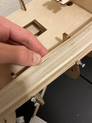

Hi all,
I’m building San Felipe 1/50 and I’m in the planking phase. I was wondering whether I should apply glue in between planks or just the ribs of the ship?

Yes! ALWAYS glue the planks edge-to edge to each other. The planking becomes a solid shell, and very strong.

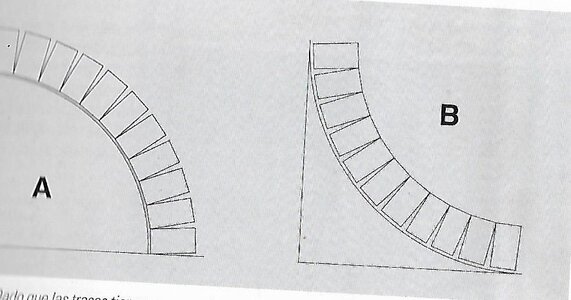

One thing to consider when planks are on concave or convex curves is the need to taper the edges to accomodate the angled contact faces for a tight flush fit which asssures glue penetration and adhesion. It takes some time but it is worth the effort to have better "aligned" strakes of planks. Where there is no curve involved then a square edge works well. Just a consideration. Rich (PT-2)

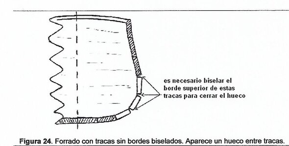

And now to expand of what was said further down from the original question, one should not get confused between "taper" and "bevel".
When planking a hull, you will generally need to consider both, as they work in tandem because of the shapes needing to be covered.
The taper is the change in the width of the plank from one end to the other (on the plank itself). For example: when the same number of planks is required between the front and the middle area of the hull.
The bevel is the progressive change in the angle cut in the edge of the planks over its length, so that each plank tightly fit the one above and below.
In both cases the thickness at the edge of the plank is constant.

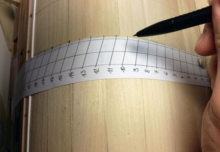

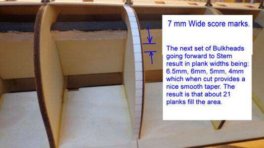

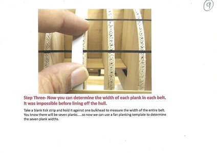

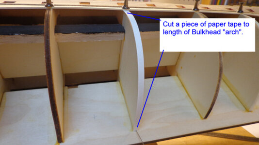

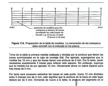

without any doubt. Do not forget to shape the lower edge. start from about 2 mm below the main deck with 2-3 planks. then measure the main bulkhead and divide by the with of the plank. this will give you info on how many planks are needed. then going forward this measure are changing for each bulkhead and the planks will have to be shaped accordingly. the best way is to fill out the gap between bulkhead -at least from the bottom up to the lower gundeck. sand it and you know have a nice a smush hull. there are many ways of doing it. Solly from the management used a speciAL PRODUCT

I just used a sanding stick or a sanding block to bevel. It was my habit to taper as needed, and then bevel as needed, the TOP edge of the next plank to be installed (working from the wales down). That way the bottom edge is straight and true and smooth as a guide for the next strake...

I do have a long vise/clamp for such long work but I do not use it for that. I work by hand with a small file or sandpapered stick setting the piece on a larger block so that my sanding hand can approach the edge from a lower angle and stroke along the piece rather than across it. It usually takes a few passes to achieve the angle that I thin is correct. For the curved surfaces both edges are tapered and the bottom one needs to be worked to mate with the one previously tapered and in place. That gives an indication as to how the upper edge needs to be tapered. Rich (PT-2)
