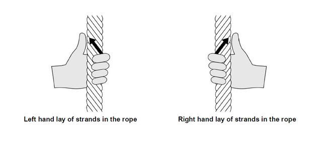

It has to do with how many layers of material are in the rope. Here's how you can see what left and right hand rope look like.
Rope has two layers, yard, and strands. So, most rope appears to be right hand. Cables have an additional layer since they are made from either three or four ropes twisted together, and are most often left hand in appearance. Cables are used for stays and shrouds. Ropes are usually used for all other lines. It is possible to reverse the twist of the fibers, and thus reverse the lay of all the larger sizes of rope and cable and you go, but usually this was not done.

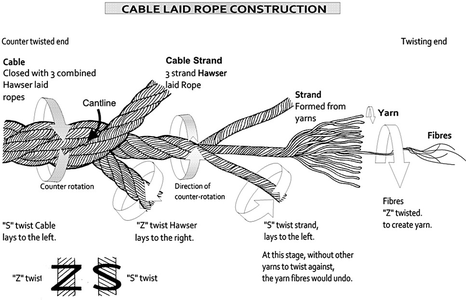

An important point is that in the making of rope, each stage of the process twists the material in the opposite direction of the previous stage. Almost all yarn for rope is spun from the raw fibre as right-hand twist (Z twist), both in the ancient world, when yarn was spun by hand, and after mechanical spinning wheels were introduced. This is different from how yarn or thread for making cloth is made, where both left and right twist can be used, and many fabrics are made with the warp twisted one way and the weft threads the other.
After spinning of the yarn, the yarns are laid into strands (left-hand), and the strands are closed into a rope (right-hand). A cable adds a further stage, laying three ropes together left-handed. The reversing of the twist is necessary to balance the stresses in the rope so that it will hold together in use. If properly laid, so that all the twists are balanced, the rope is said to be dead, and will not twist or kink when loaded.
