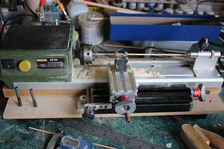

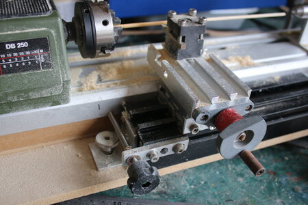

Ahoy! Shipmates! I have just given my DB250 a 'face-lift' by adding a cross-slide tool post that can be adjusted to produce straight & tapered parts. The parts came from cannibalising a 'carppy' China micro 'lathe'. The angle adjustment is achieved by slackening the clamping thumbscrew then turning the adjusting knob to the desired amount of taper. Feeler gauges can be used to set the taper for repeat production. The spars just need a bit of sanding to clean-up, works perfectly for Le Superbe's yards. I can also produce pulley block sheaves from brass.IMG_5169.JPG

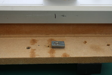

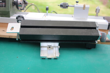

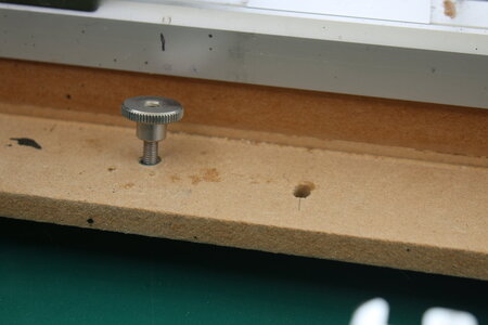

Hi, Shipmates, here's what I did:-

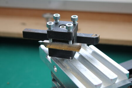

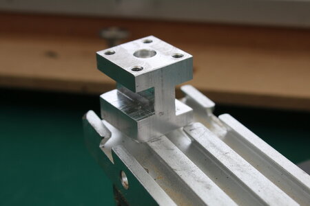

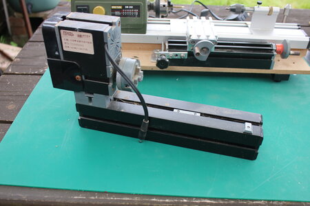

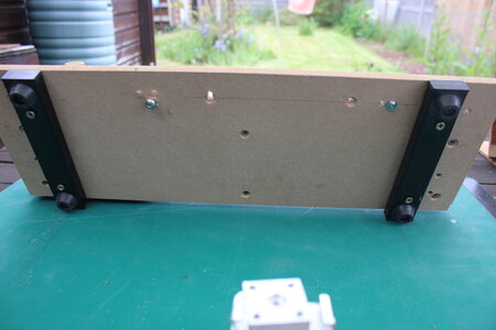

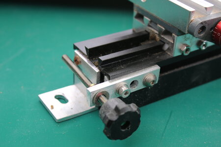

I mounted my DB250 on 2 pieces of MDF, one 18 mm one 6 mm, then I mounted it on a baseplate of 8 mm MDF with feet from another redundant tool, to which I then mounted the cross slide, using an M4 dovetail nut from the donor 'lathe'. The bracket for adjusting tapers was also attached using dovetail nuts. For producing tapers, the base dovetail screw allows the cross slide to pivot without excess movement. I am thinking of replacing the hex. drive screw with a hex. head one so that I can reach under with a spanner (wrench - US). I think the attached photos are self-explanative. I added a photo of the donor tool, & one of the 'Ship builder's assistant taking a well earned rest! I'm thinking of turning the headstock & chuck of the donor into a mini disc sander, I just need to build a suitable 'table'. Pic. 7 shows the tool post I made.
