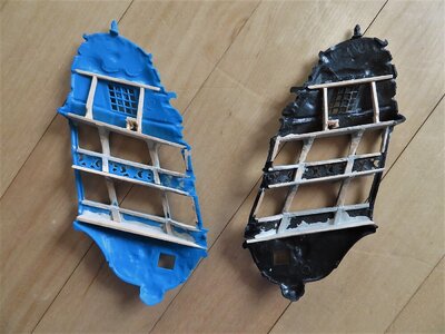

Yes I thought about doing that grinding down the partsYou could try a product called sculpey. Its a plastic putty used for decorations.
in addition you could use a Dremel and grind down the thickness of the cast metal decorations so they are not so chunky. .
maybe @SZKUTNIK can help?Anyone know of of a company or person who can mold in resin? the metal decorations at least the large heavy ones

I have an idea if you're open to alternatives; find the bottes ( side galleries) and stern part including all the small statues from a Heller 1/100 scale kit; send all of what you need to a 3d printing place and ask them to reproduce all of them in the scale you're model is; When you get it back, you can cut out the decors and statues you wish to install; Heller has the most accurate stern decors for the Soleil Royal and if you want a precise decor, it's the way to go.....You can also try with the sides, but it would be a harder task, besides the fact that section of decor on the kit is totally wrong for the Soleil Royal.....Anyone know of of a company or person who can mold in resin? the metal decorations at least the large heavy ones
Hello GuyI have an idea if you're open to alternatives; find the bottes ( side galleries) and stern part including all the small statues from a Heller 1/100 scale kit; send all of what you need to a 3d printing place and ask them to reproduce all of them in the scale you're model is; When you get it back, you can cut out the decors and statues you wish to install; Heller has the most accurate stern decors for the Soleil Royal and if you want a precise decor, it's the way to go.....You can also try with the sides, but it would be a harder task, besides the fact that section of decor on the kit is totally wrong for the Soleil Royal.....

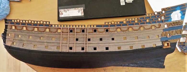

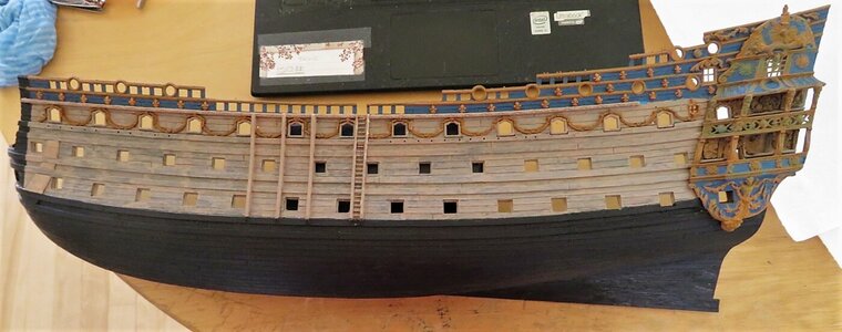

Thanks a lot for the document MarcOh, here is my own ship in progress you will notice there are some modifications in the number of canon ports and in the side decoration
