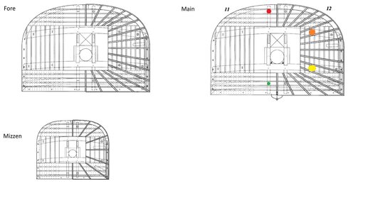

I'm prepering for my future build of CDM. Maybe somebody could answer my questions. Usually lines that go through the front pulleys(orange) under platform go to the back pulleys(yellow) and to the deck, but in marseille lines in front go straight to deck. What is the purpose for yellow pulley. Is it for return line in crane mechanism or something else? There are also on all platforms pulleys(green) and the same question what were they used for? I marked it as blue/green because it's too far from green pulley under platform but it's closest propable pulley.platforms.jpgpulleys under platforms.jpg
So I found the answers.Those color points aren't blocks places. They're eyelets that connect crosstrees with platform. Pictures are from 3rd book about 74gs Jean Boudriot

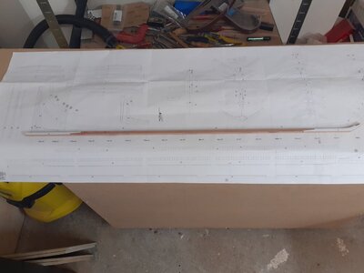

The construction begins slowly with the axial frame and with pleasure. The whole ship will be in pearwood (Belgian school).
