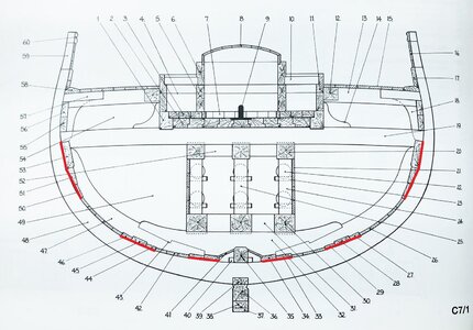

For stability of the hull structure they installed the so called thick stuff planks or clamps - they had to be correctly installed from the bow (keel) towards the stern. These were important to work against torsion of the hull and other forces (marked with red)

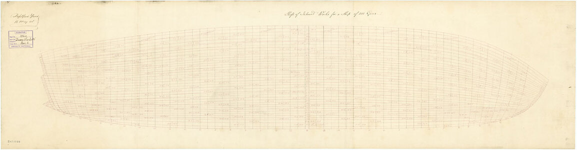

Unnamed 100-gun First Rates; Queen Charlotte (1810)​
Scale: 1:48. Plan showing the internal planking expansion for unnamed 100-gun First Rates, and Queen Charlotte (1810), a 100-gun First Rate, three-decker, building at Deptford Dockyard. The Queen Charlotte was the only 100-gun First Rate being built at Deptford Dockyard during this period.

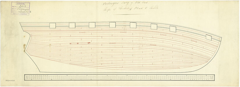

Podargus (1808)​
Scale: 1:48. Plan showing the internal planking profile (expansion) for Podargus (1808), a 14-gun Brig.
Date: NMM, Progress Book, volume 7, folio 205, states that 'Podargus' was fitted at Portsmouth Dockyard in 1808, repaired at Portsmouth Dockyard in 1809, and had defects repaired at Plymouth Dockyard in 1810.
