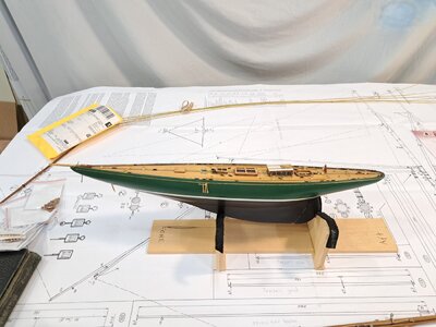

Much more challenging with models. Especially J-class boat hulls. I did use commercially available spray paint on "Endeavour I" and "Rainbow" which worked out ok.
I painted the hull of my Shamrock V with acrylics and a brush, with the result, according to the critical eyes of some honest model building friends, that the outcome was successful. But not without a LOT of anxiety and sweat equity. One heck of a lot of sanding with fine, up to 6000 grit paper, which you can't use wet on acrylics, I discovered, much to my chagrin. No matter what, if you use brushes, there will always be a ghost of the brush strokes. Whether in reality, or just in my fevered brain, I ain't too sure...CautiousView attachment 393564
