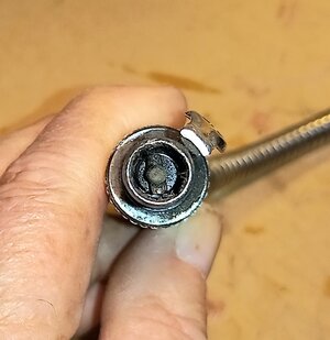

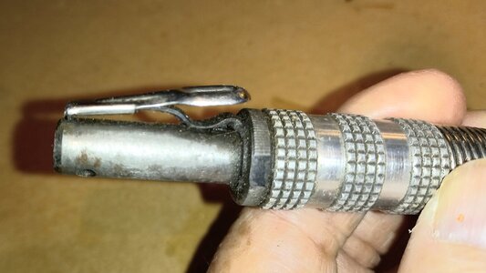

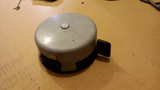

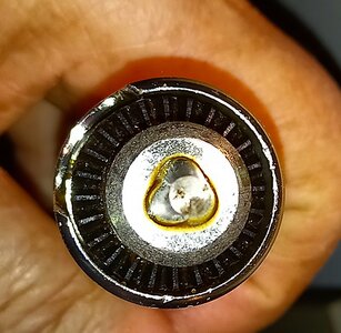

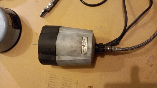

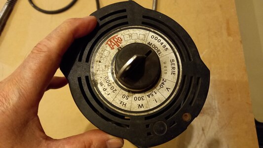

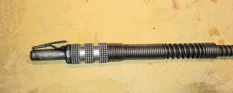

I have acquired this Faro flex lead machine for carvings etc, the motor runs really great and the speed controller is just fine, but it doesnt have a hand piece, I was wondering if anyone knew what type of hand piece it uses, I will attach some pics,
the main body of the motor,
top view,

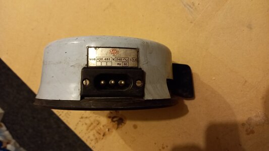

the foot speed controller,
side view,
this is the end of the flexible shaft to which the hand piece attaches,
close up view,
another angle,

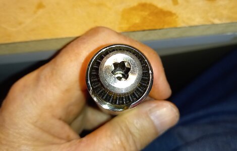

and the connection inside the flex shaft,
any help would be much appreciated,
best regards John.

the other option is to convert the flexible line with one that uses typical handpieces. Would depend on the thread size at the motor.

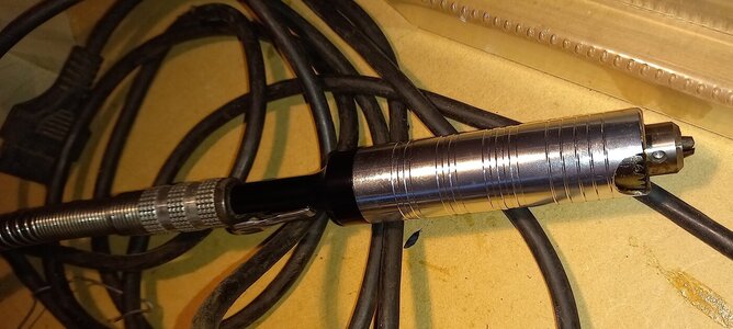

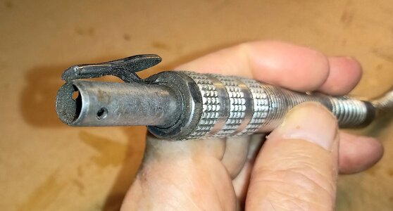

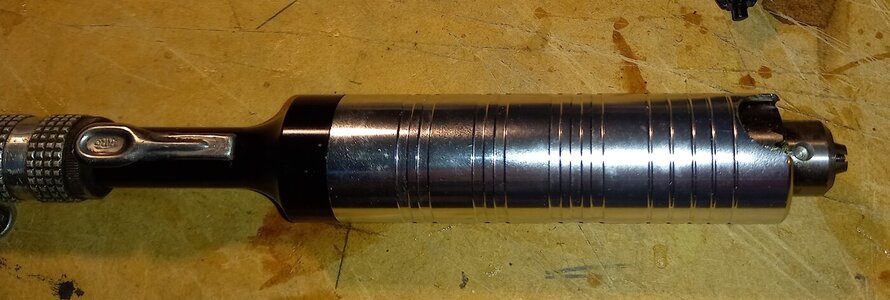

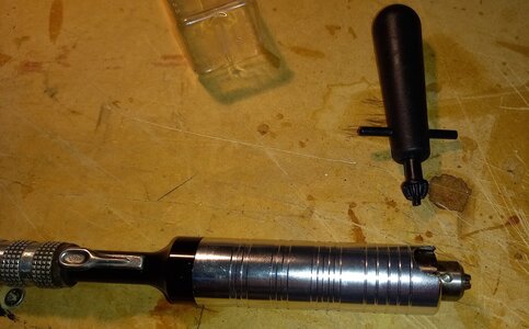

My new hand piece arrived today, here it is attached to the flex lead, it just slipped straight onto the connecting part and the clip locked it in place,
I managed to get one that has an inbuilt chuck so that I can use any of my drill bits with it,
and another view showing the clip locked in place,
it came with two chuck keys this longer one and a smaller one,
the jaws close right up to zero,
and open quite wide, I will hang it up tomorrow and give it a try out, it ended up costing AUD $24 including shipping and only took two weeks to arrive,
