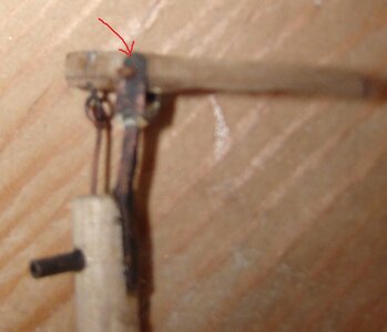

I've made this Elm pumps. It went OK except for the pin that holds the handle on. If I just cut it off short, it falls out. I've already blackened it(as well as that went)so soldering is out. I suppose I could just glue it but then the handle would be stuck in one spot. Am I trying to do too much in trying to keep it working? Is there a method for finishing a joint like this that I've missed? There is a red arrow pointing at the joint I'm concerned with. Sorry for the quality of the picture but I can't seem to get it focused any better. (actually I left it blurry so you couldn't see what a crummy job I did on the pump:):))

What is the diameter of the wire?

G'day Don, is it possible to just put a dab of CA glue on each side, should be enough to hold it in position,

I was just afraid the CA would wick into the joint and stop it from working. I guess I'll stop worrying about that and just glue it up.
If you use a toothpick to apply the CA glue on one or both of the outer joints, and use the thicker type of CA glue (the medium one), it won't wick along the pin to the center joint. The pump will work just fine.
I tried medium CA (BobSmith) and it wicked in so the handle is fixed now. I'll live with it. There's no water in the bilge so I can't test it anyway:):)

My approach would be to find the next larger size wire say 18 or 1 gauge for a tighter fit,

Well that would just be too logical:):). Years ago I bought a complete set of numbered and lettered drill bits so I would be able to "sneak up" on any hole and get a precise fit. Never thought of it this time. Getting old. Great idea!

1. You can coat the pin and hole in bees wax. It will provide enough friction to keep the pin in for the short term.
2. The wax will harden with time and secure the pin until someone breaks the bond. I do it all the time.
3. It sometimes helps to dilute the beeswax with a little PAINT THINNER (don't use turpentine it does not dilute wax very well).
