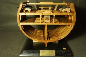

I purchased Triton Cross section sometime ago online that recently arrived.
I decided that I needed a break from planking on a large ship like my USS Constitution and did not want to rush it. As I had seen another build log of Halifax I decide that was a big step but with the Triton Cross Section to learn the process of building a POF.
I have started building the building box for the Triton and started looking at the manual to get a feel of the build procedure.

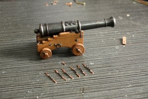

The cannons in the kit are the best I have seen in a kit, but you will have to wait to see them.
Cheers

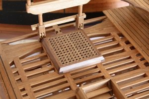

#16
Bob
Thanks for visiting my build log. I have posted some photos of what Triton should look like at the start of the build log.

#18
Hi Bob
No, you did not miss them I only included them this morning.
It looks like it will make a stunning model. Just hope I can produce to a standard near of what is in the photos.
