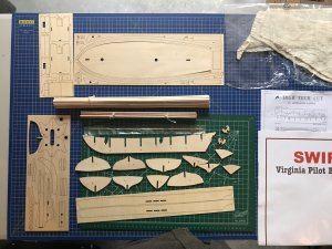

After taking a little break after my Albatros I am back in the shipyard. I purchased the Swift 1805 by AL and had originally planned to build this as my first wooden ship build but for some reason I worked on the Albatros first. My goal with this build is to continue to build skills in planking and rigging and to add some experience with painting a ship. I purchased the current Swift kit which does not include the open lower deck or provide for a second planking. While I could have second planked I wanted the experience of painting a wooden ship vs staining it for future projects on the shelf like Bluenose and Rainbow. A few pics follow of my start. This kit is fairly straight forward and much simpler in design than the Albatros was re rigging. For some reason AL has decided to ‘save’ use of paper by replacing printed instructions with a CD version. While I appreciate their desire to be efficient certain things are best on paper vs electronic media and detailed instructions would be one of them. I do like some of the tools AL provides in the kit in particular small sanders and tweezers - can always use more of these! 037ECBCD-A9F0-4219-9717-9CC97EB717BC.jpeg 8BE363CB-C936-42F0-95B1-F192389EC23E.jpeg F0C89C0E-E763-433A-A8A2-91A390AFF1E8.jpeg 35AED184-18B3-4E11-BA7B-2AB7E4BB0143.jpeg

This is a nice kit - the parts look clean and well made. This should be a nice build. I see that the Bulwarks are preformed. That is nice. As you "fair the hull", during the process, I would stop and see how the Bulwarks fit as you continue to proceed with the fairing. It is easy (at least for me) to get so carried away with fairing that I took too much wood off the Bulkheads.
Of course, you might already know this and I don't mean any offense.

Thanks for heads up Donnie. I was wondering about how they would sit and of course the build instructions make no mention of this future requirement although the pictures give some clue. Please keep the heads up coming. Advice is always welcome.

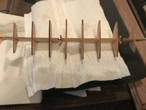

#6
I built this kit...fun little project. One caution, though. Very few bulkheads. At the bow this can be a problem as it’s hard to maintain the smooth curve need in the planking there. It tends to “flatten out”. I’d recommend full sized bow blocks to prevent that.

#8
Thanks for the advice. I am a bit delayed in posting an update. I had already worked on the planking before seeing this advice. I did get the sense in planking it was a little rough in that area. Required some shaving, sanding and filing, sanding and filingto get decent. This ship is being painted so not sure yet how this area will show up but it looked pretty good to move forward with. I’ll post some pics of where I am in another post.

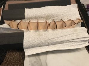

#10
As I mentioned I have moved forward a bit since my initial post on the Swift build. Since then I have added the false deck and planked. Tons of elastics on the false deck gluing as it bends on two planes: curved center down side to side and curved center up front to back. Only my second build but haven’t seen that. Went slow using titebond and elastics and it works. Next day it looked solid. E9ACB855-5BE2-49F1-9255-2BA4027BB261.jpeg 9D52BFF5-3112-45F1-8F0D-D39734C65133.jpeg
