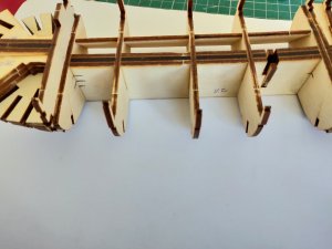

Hi Maarten, I take an hour's lunch break when I sit in my car, listen to the radio and read. What I have started doing is taking the various parts of this kit with me and spending some time at lunchtime filing off the laser char and making sure the parts fit ok, that way I can then glue them in place when I get back to the house.
The weather has been really good all weekend so I've been playing Tennis and taking Archie for walks around our local park but I did manage to fix the 3 Bulkheads that fit in the middle of the Boat. These slotted into place without me having to do any "clean up" and where fitted dry and then diluted wood glue was run along the joins. The fit is that good I could get away with not using glue on any join.

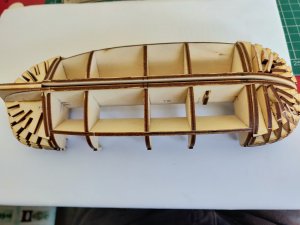

I have now finished working on the Stern Extensions, dry fitted them, and then I ran watered down wood glue into all the joins.
Instead of smoothing off all the rough edges on the Bow and Stern, I decided to fit what the instructions describe as the "Rough" Planks. These are the Planks that fit to the middle part of the Hull. These all come on a laser cut sheet.
6 straight Planks are fitted each side starting at the Keel and then the pre-shaped Planks are fitted working down from Deck level. Even though the Boat is pretty much solid I still decided to plank both sides one Plank at a time. 2 Planks were removed and cut to length, they are supplied about 5mm too long. Following the written instructions I soaked them for about 30 minutes and then filed an angle on the side next to the Keel to get a better fit. These Planks were then glued in place and clamped.

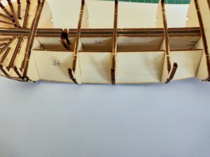

I have now fitted the 12 "Rough" planks and before I turn my attention to the pre-shaped planks I fitted the 2 Cabin Window outer Frames. These needed to be chamfered on each outer edge so that they would fit between the Bulkheads in the Stern area.
These Window Frames will be filed down to match the Hull curves, and then I'll paint inside black before fitting the Window Panes.
