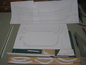

This building log of The Caravel Pinta is based on the book ‘the Ships of Christopher Columbus by Xavier Pastor’ and detailed drawings prepared by Jeff Staudt.
Details
Class & type: Caravel
Tons burthen: 60 – 70 tons
Length: 17 m (56 ft) on deck
Draught: 2.31 m (7.6 ft)
Complement: 69
Keel & Keelson Assembly:
The following parts are made from European Beechwood
1. Keel
2. Sternpost Keel
3. Sternpost
4. Stem
5. Apron
6. Deadwood
7. Keelson
8. Stern Keelson
9. Apron
This is a few photos of the assembly.
Any comments or questions are appreciated.

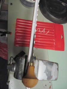

Frames:
I really like the design for the double frames they are sisters with 5 pieces on one side and three on the other using all butt joints quick and easy to make.
The following photos shows the construction and temporary placement of the first few square frames on the keel

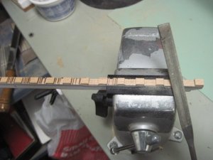

Half Frames:
There are 14 half frames 6 in the stern and 8 in the bow on each side of the keel and hopefully, they will be somewhat symmetrical. I like to build from both ends and watch what happens in the middle.
The following photos show the construction of the bow half frames.
