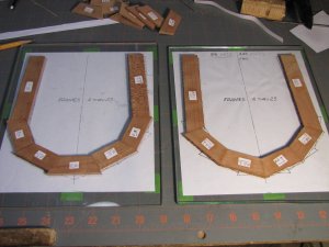

Hello Ship Mates
I thank you all very much for all of your visits to my build log on the Oliver Cromwell, also for your very kind words and nice comments.
Back in the Old Ship Yard the little fellows and I have completed the sanding for all of the segments for building the center rib frames. We have also cut out with my Admirals help two heavy pieces of glass that are .200" or 5 mm thick, sanded away the sharp edges and taped our two framing diagrams to the reverse side so that we are able to use our clamps to hold the segments in place for the glue to dry. We did last evening glue up our first set, 19 more to go, ENJOY.
IMG_5063.JPG IMG_5064.JPG Regards Lawrence

Hallo Lawrence,
I am happy to see , that you are also using the heavy glass for the framing like myself.......I made very good experience with this way, absolutely flat (and you can watch the glue drying ;) )

Hello Uwek
I thank you very much for your visit to my build log, also for your very kind words and nice comments. Yes, the heavy glass is working just fine. The only trouble I had is the glass is very slippery but resolved that by adding strips of masking to the glass face, ENJOY.

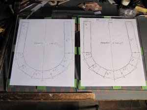

#48
Hello Ship Mates,
Once again I do thank you all very much for all of your visits to my build log on the fine looking ship the Oliver Cromwell. Also for your many very kind words and nice comments. Back in the Old Ship Yard the little fellows and I continue with our frame building blanks we have completed 34 of the required 40 for the center section of the ship. At this point, it seems never ending but then the end is finally in sight, and then we can move along to cutting out the ships keel and bow timbers that will be surely a very nice change in pace. My Admiral Bernadette has given me my fathers day gift early this year, she has presented me with three build books they are The Fully Framed Model, HMS Swan Class Sloops, volume 1 and 2. Along with Swan 1V, Sail Making Supplement from the Revised Edition. I thought that this was very nice of her to do so, ENJOY
IMG_5071.JPG IMG_5072.JPG Regards Lawrence

Hello Ship Mates,
Regards Lawrence
I never did the framing in this way, so I am every time curious about when you post a new posting.......it is very interesting to see.
One question to your new books from Antscherl......I have the old versions and would be interested, what is the difference......would it be possible, once you have some time, that you make a photo of the contents-listing and send it via mail? So I could compare.....
