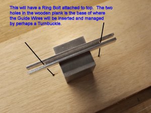

This is the Guide Bar and the Weight. I am going for about 200 to 250 grams. It is almost time to bring all this together and make it work.
Two Guide Wires about 9 feet long each. Ready to mount to ceiling next. Will use toggle bolts to do that. I am thinking about using Turnbuckles to keep the Guide Wires tight.
